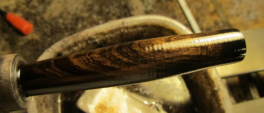

Here's what I've done (and started over a couple times!)
I tried a CA finish - what a joke that was.
Just sanded it all off back down to the wood and went with my Maguiers car polish like I do with my plastic pens. May not be the best thing - but it turns out okay. Feels really nice to the touch. Sailor and Faber Castel don't put clear coats on their wood pens. :biggrin:

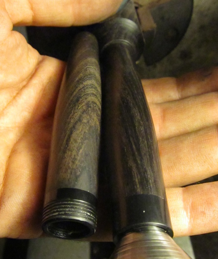

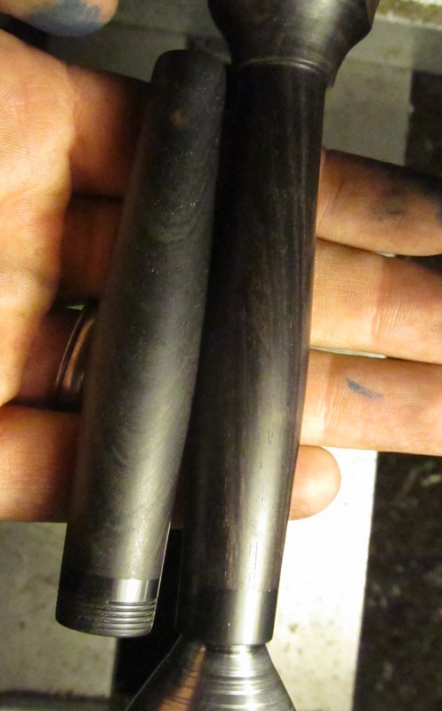

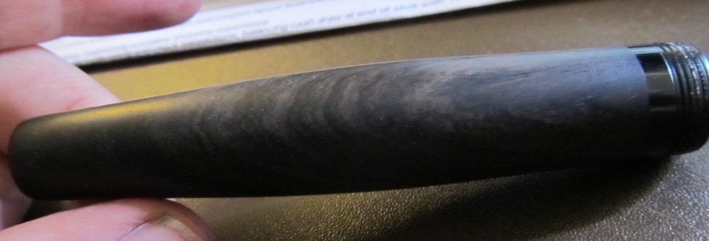

After I sanded it down I noticed my threads were pretty much ruined. They still work fine, but they LOOK awful.

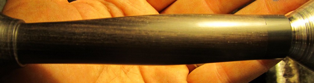

2 barrel by snennewton, on Flickr

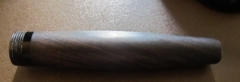

002 by snennewton, on Flickr

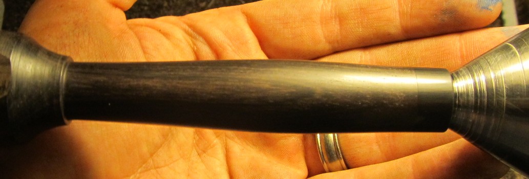

001 by snennewton, on Flickr

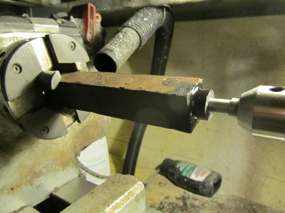

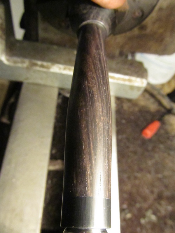

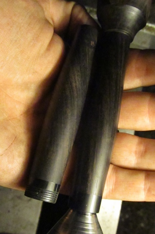

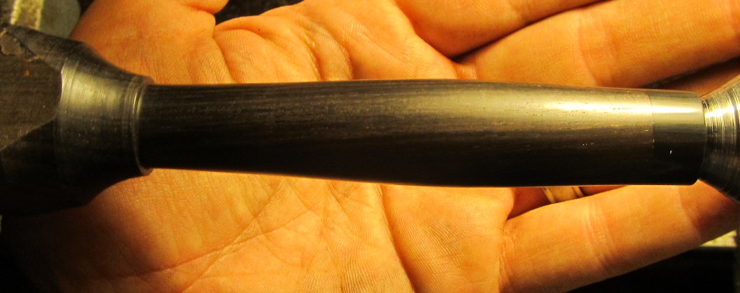

So here's my do-over.
I took better care to get a precise fit of the insert. I don't want anything off center. This stuff cuts better with my big U gouge than with the wood chuck. This wood just sort of sticks to the carbide tip and gums it up - makes it dull quick.

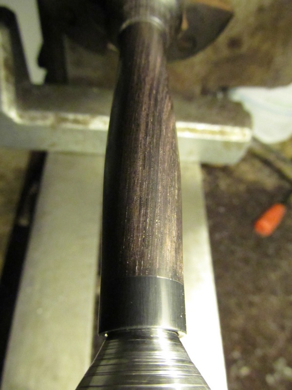

003 by snennewton, on Flickr
Hopefully things will go better this time.
