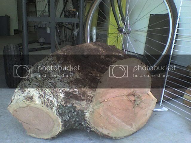

Tree removal people cut me this section this morning! This is an old dead tree that had been sitting there for several years with no life left in it. The limbs were all broken out and no leaves were on it. I'm thinking that means the wood is pretty dry already, since it has had a chance to dry on the dead tree.
Am I right in this?
I'll share with anyone who is close enough to help me cut it into bowl and pen blanks.

A rule of thumb for air drying wood is that it takes about a year for each inch of thickness. Now, some woods dry faster than others, but on average, a 12-inch thick tree trunk would take about 12 years to dry out all the way through.
If someone gave me that chunk, I'd probably cut it and seal the ends (actually, I'd take a moisture meter to it, but I presume if you had one you wouldn't be asking here).
