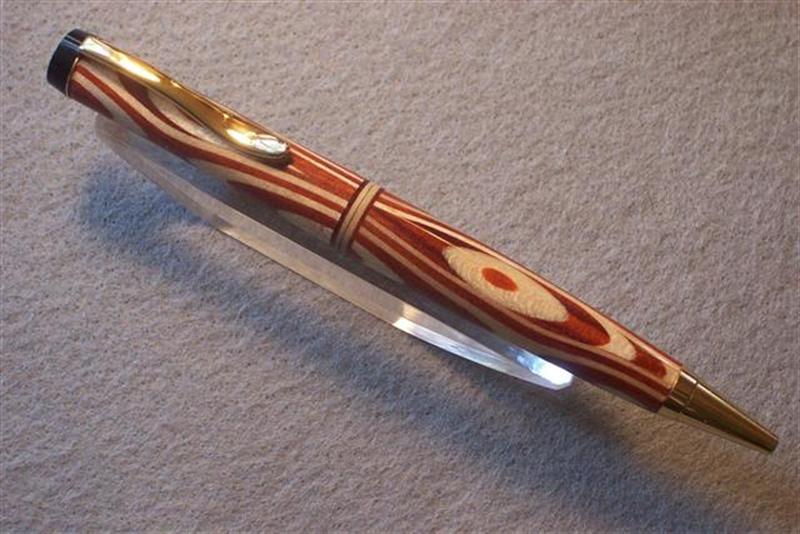

Here's an example of a modified Perfect fit.
Note CB is on both halves, same method used.
