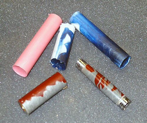

Okay, you want a picture, heeeeeeeeeeeeerrrrrreee it is!!! And yes, I did have a puddle on the bench. See the short blue and white blank?!!! I thought I'd try some of fancy Saran wrap, the clingy stuff instead of duct tape to seal the bottom of the mold. Weeelllll, it wasn't clingy enough!!! Bubble Gum Pink with some green pearl mixed in, Metallic Blue and White, and Maroon and Silver (local HS colors)

Bubble Gum Pink... Bazooka Joe would be proud!
All colors are actually PPG Concept DBC's except for the pink which is a DCC. Clear as mud right?!!! I'll see if I can find the time to pour a few more of the pink.
Automotive colors or tint? (DBC) Basecoat. Concept(DCC) Acrylic Urethane

<br />All colors are actually PPG Concept DBC's except for the pink which is a DCC. Clear as mud right?!!! I'll see if I can find the time to pour a few more of the pink.
Originally posted by its_virgil
<br />Automotive colors or tint? (DBC) Basecoat. Concept(DCC) Acrylic Urethane
don
Yep, we have a winna!! Gotta go with what I know!! DBC's are a two stage base coat. Basically pigment which requires a clear coat to protect it both from abrasion and also UV. The DCC is a single stage which is formulated with a built in gloss. Can't wait to try a few custom paints!!!
Thanks for the info Greg. Now is the DCC the pigment that is mixed with the paint to get the color or is it the paint its self? Can I buy just the pigment if that is what it is? If so where?
No, DCC is a single stage paint. One must mix in reducer and hardener to spray but none are needed when mixing with resins. Could get a bit pricey for someone simply wanting to tint resins. I use leftovers so I have no investment. One can buy just the pigments, otherwise known as toners at most custom paint supply houses.
