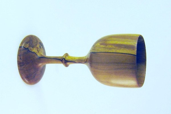

Made this wine glass shaped challice today. It is 2-3/4" X 6". I got this spalted cherry blank from landfill lumber (Victor). Danish oil and Bealle buffed.
A little while reducing the stem, any thinner, I'd have had to do a tail stock draw on it.
Glenn,
I stuff the cup of the my wine glasses with a wad of paper towel and jam the tail stock in on the towel... reduces the wobble to almost nil...
Really a nice looking glass... what did you use to hollow it out... I've bought a termite tool to do my wine glasses... love that thing... it does take the wood out and leaves a pretty nice smooth finish inside... unless you get it turned wrong, then it will gouge the wood... still it's the best I've found for hollowing the insides of the wine goblets.
Glenn,
I bought the termite tool, haven't used it much yet. Need more practice.
Very nice glass. I gotta try one of those.
Glenn,
Thanks, I used a 1/2" bowl gouge followed by a scraper on the inside. Took no time at all to hollow it out that way, It then took me most of an hour to turn the stem without support, had to take light cuts. Since then, I bought a 3" cone shaped live center to tape the cup end to, so I can retract the tail stock to finish the stem.
Very nice Glenn as always sir.Is that from the new batch of wood or an old blanks?The black line is perfectly placed on the piece(I know you meant that right,LOL).See you at the next meeting sir,Victor
