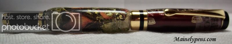

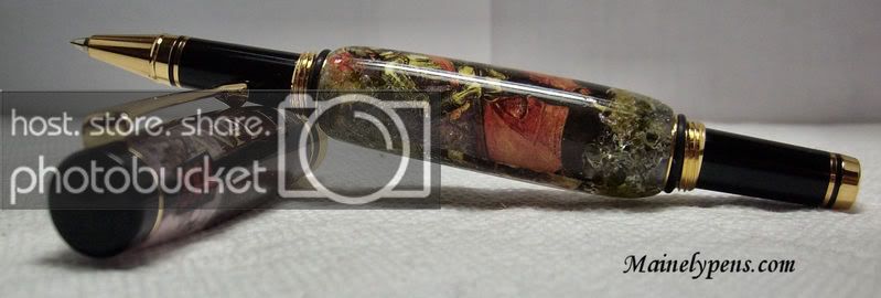

I have already posted this in another section in an attempt to get some advice. This pen is the final product of IAP members help, and advice.
It is a Parker Classic Rollerball Pen.
The Cap:
I took the foil wrapped around top of wine bottle and glued it along with a couple pieces of label to blank. Then casted it in clear resin.
The Main Body:
I took the center of label (Customer request ) and glued it to blank, then crushed up some glass and glued pieces to label, around outer edges of picture to allow user to still see the art on the label. Cast it in clear resin.
Turned them both down very carefully, considering I had one shot at getting this right. I coated both pieces in 6 layers of CA to ensure a long life. Only a couple of very small spots did the glass poke through. The CA coat took care of that. I think you all know the steps from here.
The Cap:
The Main Body:
