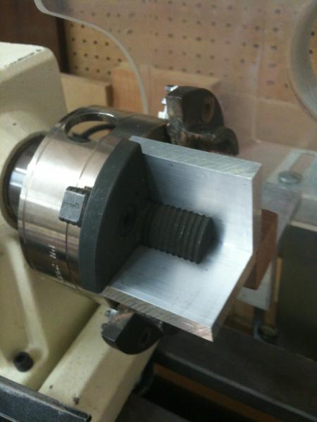

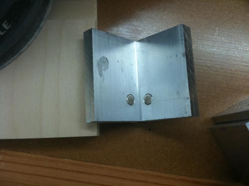

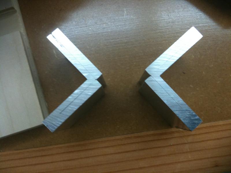

I built these auxilliary jaws today and they work very well. I got the plans from one of the members here that posted the plans but for the life of me I cant find the post. Thanks David great plans.
