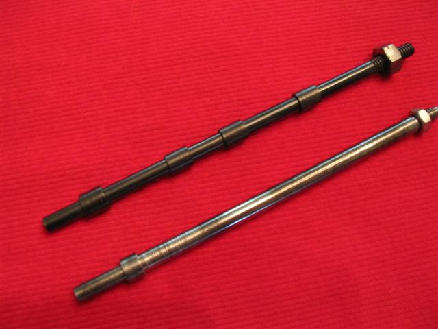

not to start a fight here, i'm going to cancel my previous opinion. opinion's are just that. however i'm also including a photo of my A (upper) and B (lower)mandrels. they both measure 1/4" on the left end in the picture. the el grande and perfect fit pens that i have bought at woodcraft bushings fit on my A mandrel. i only have one set of bushings left for my B mandrel therefore it does not get any use as i don't even remember what kit they are for. i honestly feel there is no longer a "correct" answer to the authors question, however my A and B mandrel will fit in my PSI 1/4" collet. nuff said.

For a change, this appears to be a case where everyone is correct.:biggrin: The answer that covers most situations is that an "A" mandrel requires a 1/4" collet and a "B" mandrel requires a 5/16" collet or the metric equivalents.
It appears that Bob is using the Berea High Precision Drill Driver System and I am guessing the ends of both the "A" & "B" mandrels are milled to 1/4" to fit into the HP arbor.... sort of analogous to threaded mandrels where both the "A" & "B" mandrels are threaded to the same 1/4" x 28 so they will fit the same arbor. (Woodcraft mandrels, excepted, as they are threaded differently......10x32 IIRC)
I use the Berea high precision mandrels and they are not both turned to 1/4 inch or slightly under. The "A" mandrel is ~0.246 (letter-D) and the"B" mandrel is letter L and is driven with a 5/16 MT2 collet. The "B" mandrel is less than a year old.
