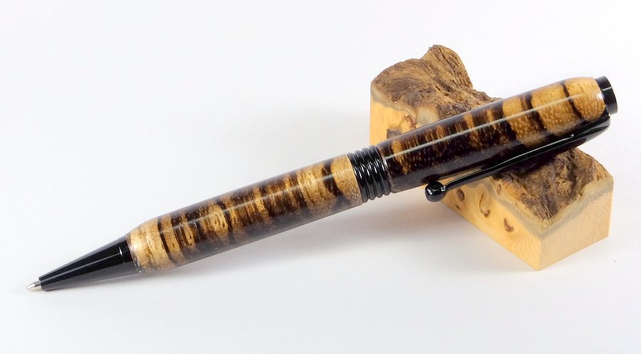

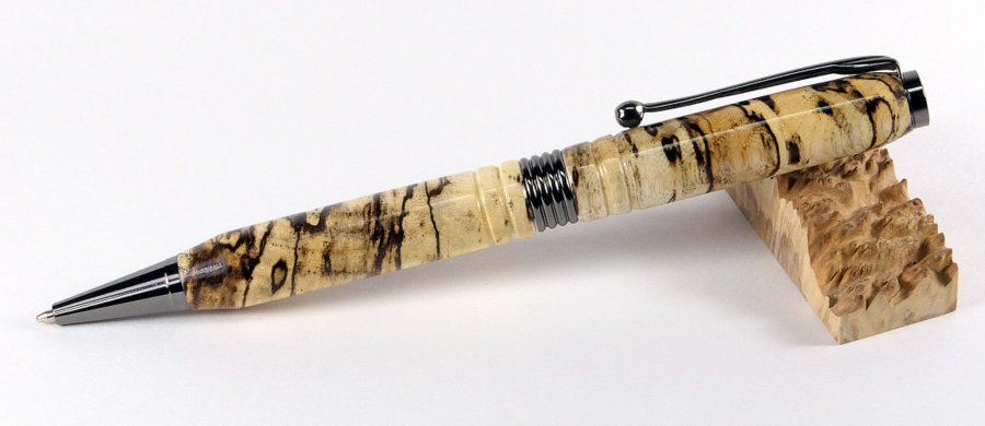

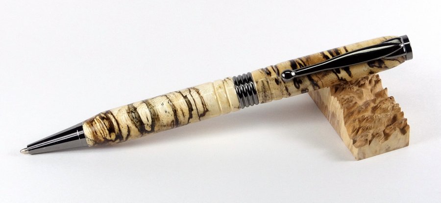

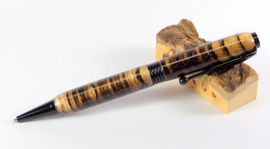

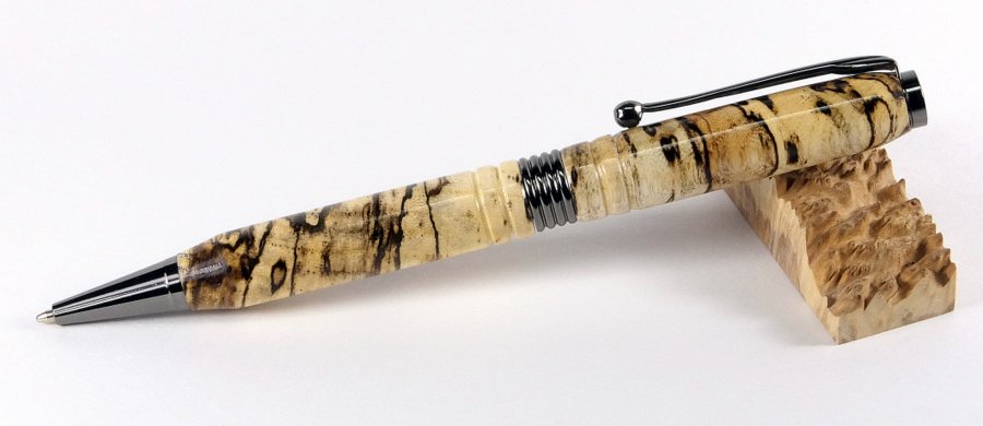

Hackberry two coats CA no sanding after each coat. Works for me. Zebra Wood one coat CA no sanding after.
Peter.
