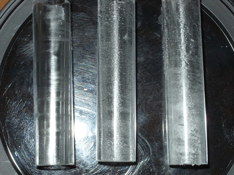

I ran a little test to see the differences between drilling with a lubricant and without.
Note: This was done out of curiosity, not to call anyone out on their process.
The picture below consists of 3 pieces of 1/2" diameter, extruded acrylic rod that I drilled an 8mm hole through. All were drilled at the same speed (1650 RPM) and approximately the same feed (3/8" per plunge).
Now, this being extruded acrylic, these results are (or at least should be) exaggerated when compared to cast acrylic. If anyone has some clear cast acrylic around that they'd be willing to experiment with, I'd be interested in seeing those results.
I started with the piece on the right. No fluid was used in drilling this piece.
The middle piece was drilled right after the first using a small squirt of water after each plunge.
The piece on the left was then drilled using "PAM Spray for Grilling". As before, a small amount was sprayed into the hole after each plunge.
Finally, I set another piece of acrylic in the vise and drilled it. This was done to see if the cumulative heat build up had an effect on the pieces. Other than the residual spray on the bit, no fluid was used. About three quarters of the way through, this piece actually melted in half on my drill bit and is not shown.

heath, Im trying to understand why you feel you need to lube the drill hole(so to speak)? Sorry about the "out of context", if you drill using a lower rate of speed and your plunge rate is also slow using 1/4" increments, you should be ok. A sharp bit also helps! Sometimes i hold my shop vac up to the blank vise to suck the shavings out as its drilling and my thinking on this is that those are also heating up, so i get them out of there, and at the same time the suction that is coming from the vac is drawing air across the bit in hopes that it actually helps to cool the blank. hope this helps.

My purpose for posting this was to show how much heat build up there is between using coolant/lubricant and not. When I drill, I do it in batches. I prefer to minimize the amount of down time. Less heat build up equates to less time spent waiting for bits to cool off. I've never had an actual pen blank melt on me while drilling.

These were drilled on a Rigid DP15000 drill press. I'm not sure what the runout is on this. An inexpensive self centering vise was used for work holding. Feed rate...about 2 seconds per plunge at 3/8" per plunge...so 3/16" per second.

Heath, looks to me like you have a good system. I would keep using it. I don't have a problem with the drilling speeds ans some lubricant. Like the picture shows, it works to make a better hole. Those not using a lubricant, i would deffinately slow the rpm down a bit. Thanks for the tests results.

LOL here is a test and photographic evidence that what we have been taught since metal shop in junior high is in fact correct, a cool bit drills a better hole. That holds for any speed folks! Only question is does using lubricant provide a significantly better hole to warrant using it?
