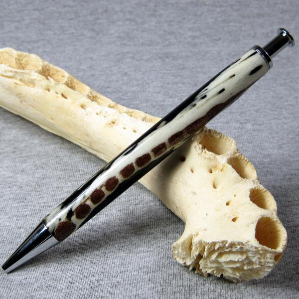

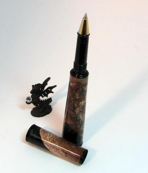

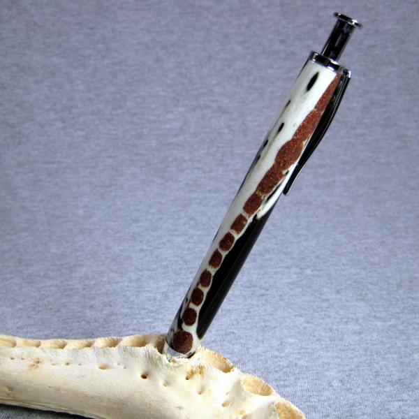

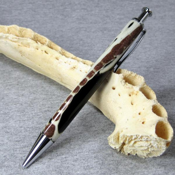

I will go first.
Gator Jaw (a 1st) with Copper Filing packing in the tooth sockets cast in black PR.
I am very happy with this pen, I knew I would not win but pushed myself to try something I have been a bit intimidated by, the Jaw.
I packed the teeth with Copper Filings mixed with Epoxy prior to casting, a 1st to fill a void w/ anything not CA.
The Pen is a Long Click, another first which was tricky to get it as straight as I did and to drill. I actually turned it down 2 times because I would take it in the house and just look at it and find errors to fix.
I built up the CA and sanded back to the bone to make sure the Bone voids the PR could not get to were filled.
I finish turned down the .15mm below the bushing and built back to .2 over. Sanded back even w/ the fittings leaving a .15mm coat of CA over it. MM to 12k, Huts Ultra Gloss, white compound to polish.
So which pen is yours and how to you step out of your box to bring it to life?

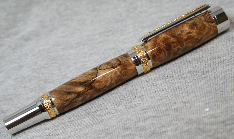

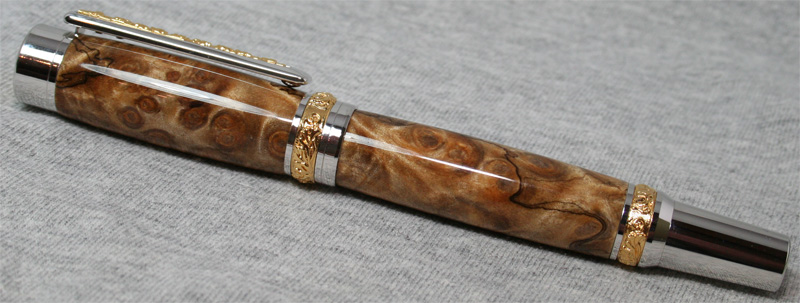

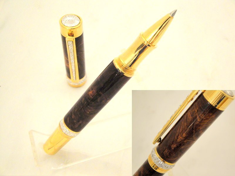

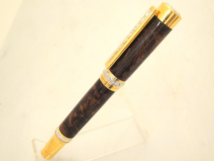

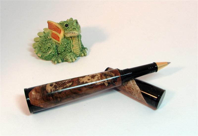

Here is my intermediate looser. I was actually getting ready to post it to another thread when yours popped up.
This is water oak burl worthless wood that was cast in a black and silver resin by Chris (Justturnin) I paired it up with a black chrome Panache kit, CA finished and polished up.
If I had to do it again, I wouldn't change a thing.
Carl,
That pen came out amazing.
Much appreciated.
Your long click was a great way to show off that length of jaw bone by the way. Much nicer than chopping it into an upper/lower/cap setup or a shorter blank. Very nice job on the pen overall.

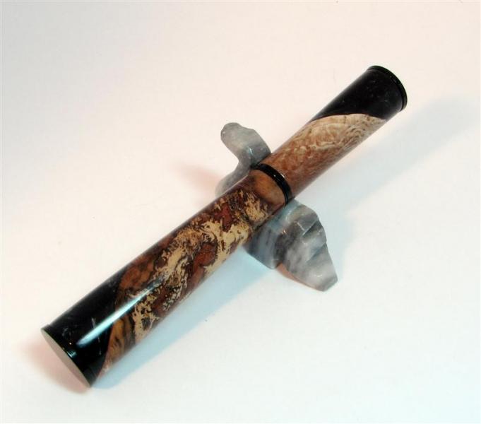

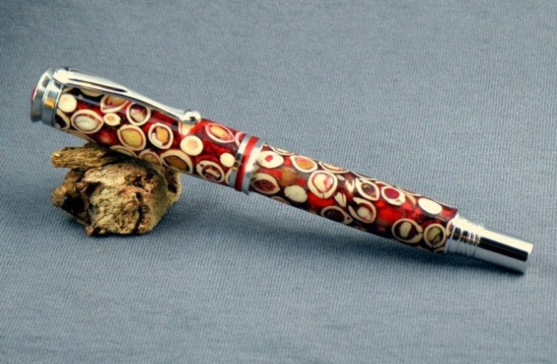

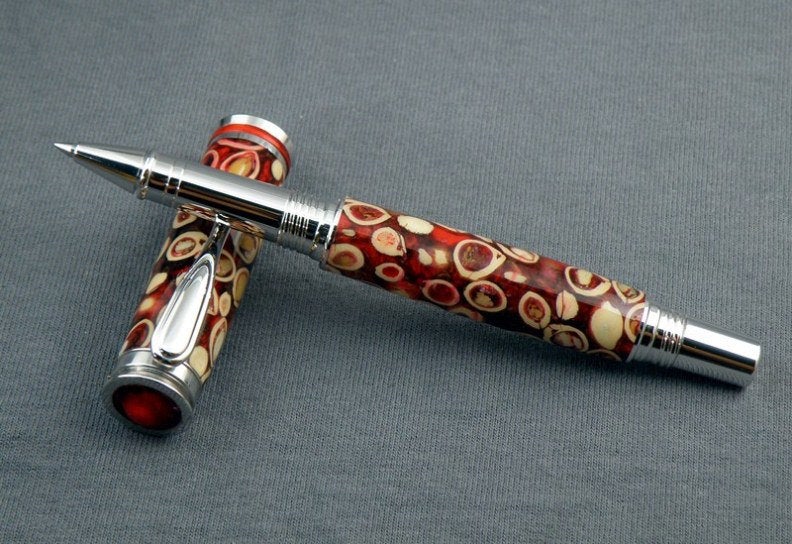

This was my entry. It didn't make the finals but I tried something I hadn't done yet, the random segmenting. I'm just glad that I wasn't one of the judges that had to pick the finalists. I thought every pen could have been in the finals. It took me almost all day to make the blank. Cutting and gluing and gluing and gluing and gluing. I used Oak, Padack, Sassafras, Cedar, Walnut and Cherry wood and Mahogany and Maple veneer. The kit was a Baron. MM to 12k, 20 coats of CA, Novus heavy and light.
Thanks for looking and any comments good or bad appreciated.
Tim

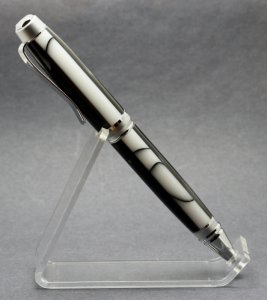

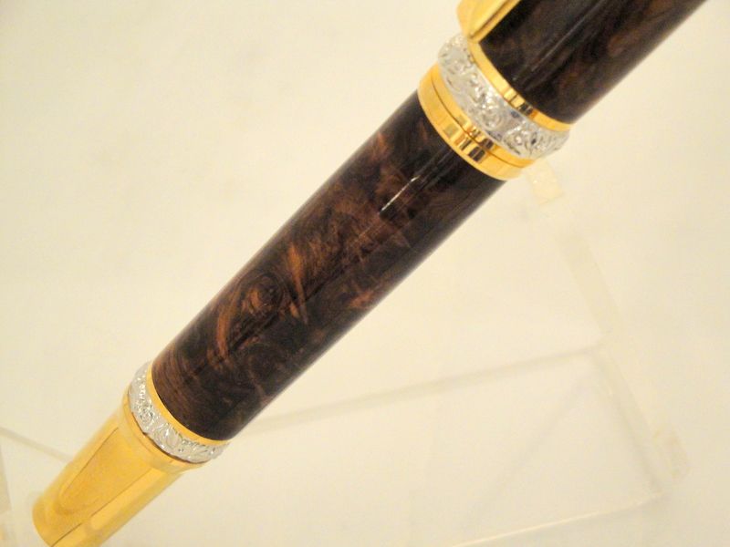

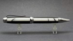

Here is my entry
Made an Atlas or Polaris depending where you get it from.
The wood is Cocobolo with a trace of sap wood. Finished
with Penturners finish and several coats of CA finish. I went
ahead and submitted my pen, guess I was the second one in the
pot, and then when I went back an looked at all the other ones that
entered, I said no way this baby is going to make it. But it was fun
entering and can't wait till next time. I am honing my skills and I will
be entering more than one level.
Thanks:smile-big:
