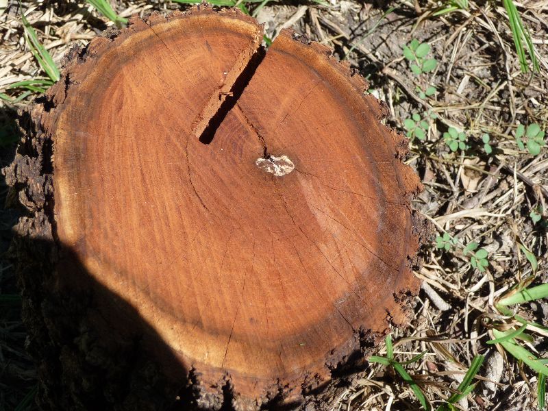

curtis, can you look at the pic tomorrwo when you have time and tell me or draw where exactly would be considered Pith? I am not sure if I understand exactly how much of the center of the wood is considered pith. these are not any where close to theh daimeter to what you cut on your milling machine last time. i ahd to cut these branches away since they were rubbing on the house and didn't want to have more damage and then the other tree that fell over the house was keeping it from getting good amount of sun to grow.
Afte ryousee the pic. you can tell me if I shoud fool with it or just thow it away.

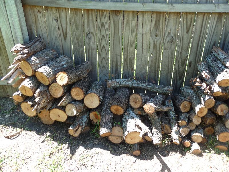

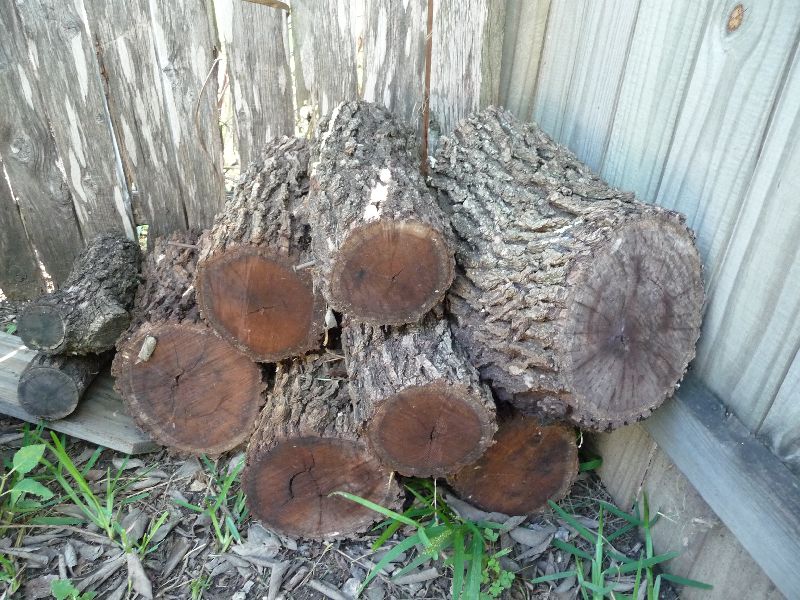

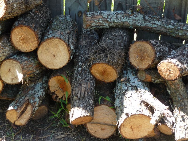

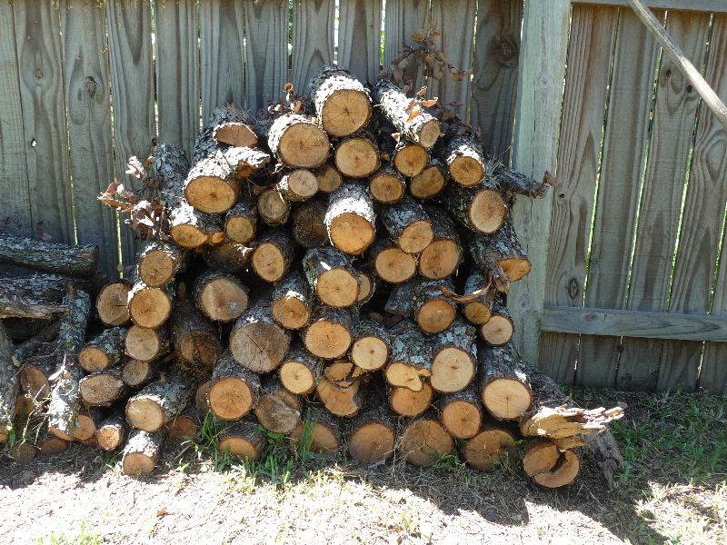

here are the pics:
descrp. from left to right:
Hackberry Cut in Feb. 2010, chopped sep. 10, 2010
Hackberry Cut in Feb. 2010, chopped sep. 10, 2010 close look
Hackberry Cut in Feb. 2010, chopped sep. 10, 2010,whole
Mesquite Cut in Feb. 2010, chopped Feb. 10, 2010
Mesquite Cut in Feb. 2010, chopped Feb. 10, 2010,attempt to cut
Mesquite Cut in Feb. 2010, chopped Feb. 10, 2010,halved

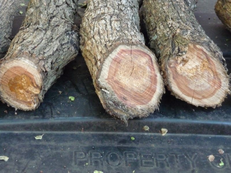

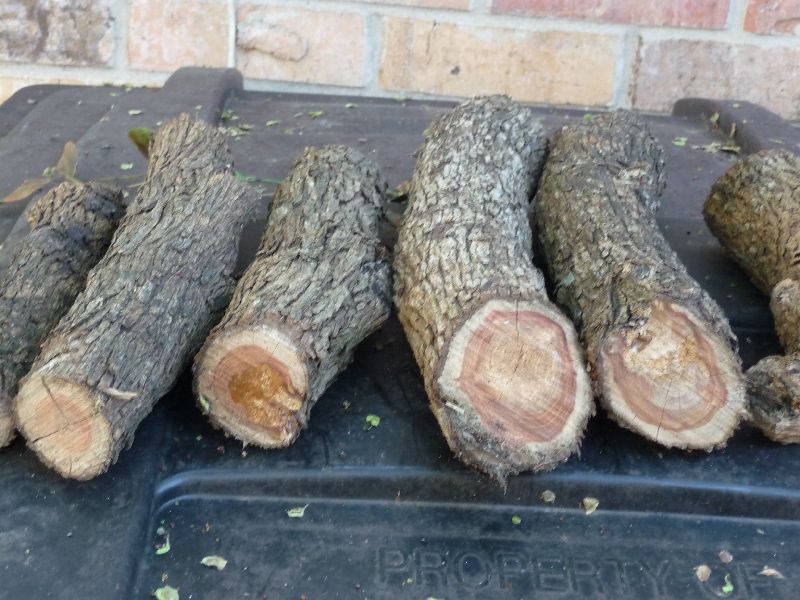

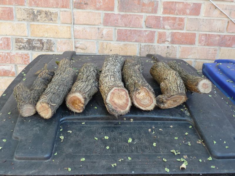

Mt. Laurel Lot#,1, Pic.1, #1--6, sizes 1 1/2x7- 1 3/4x9- 2x7 1/2- 2 1/2x9- 2 1/2x2x9 1/4- 2 1/4x6 1/2

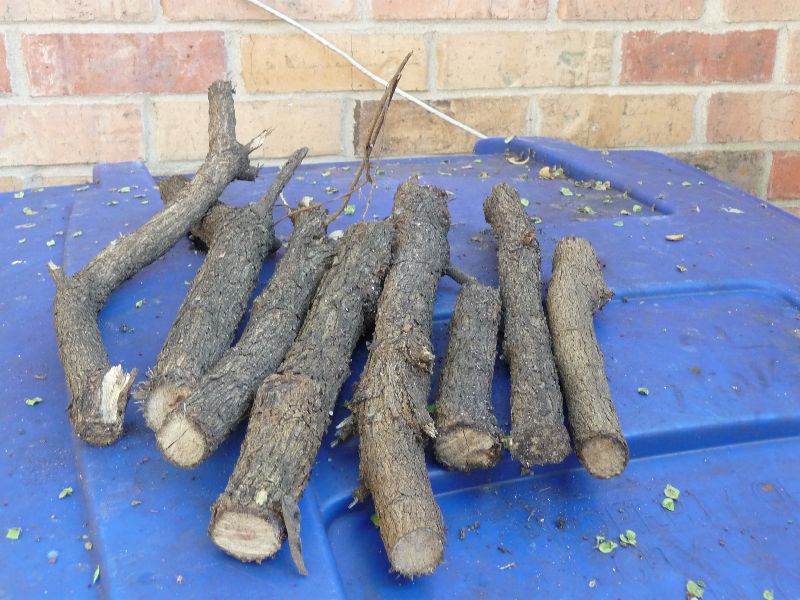

Phillip,
Your first few pics are NOT hackberry. They look much more like Tx Elm to be. The color of the wood is wrong and so it the bark. Hackberry is white to gray and they bark is way different then that. If I saw a close up, I could tell you for sure if it was Tx Elm or some other native central Texas tree. I know all of my native central Texas trees VERY well.
The mescalbean will make descent pen blanks but nothing spectacular. The grain will be straight without a lot of character other than some nice color. Still worth messing with, just do not get your hopes up too high.

As for the mescalbean, would the thickest log that i mentioned above make it if I cut it in an angle to the grain to make the orientation of the grain little more interesting?

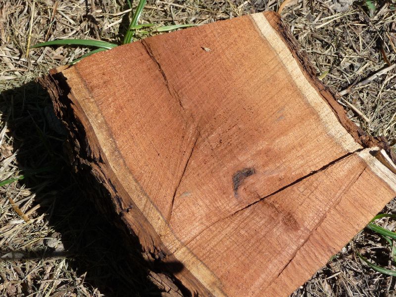

Now, as I remember when You demoed that Mesquite log at your shop you took the whole log and then You started slicing it from the top by 4" thick right? I don't have the milling machine so right now the only thing I have is the long 12" long Diablo recopro. blade and my band saw is a 10" craftsman, so in the pic #5, I started to cut it near the center is that a correct cut so it won't check or split, or am I not looking at the pith right and am I understanding the concept of cutting around the pith correctly?
