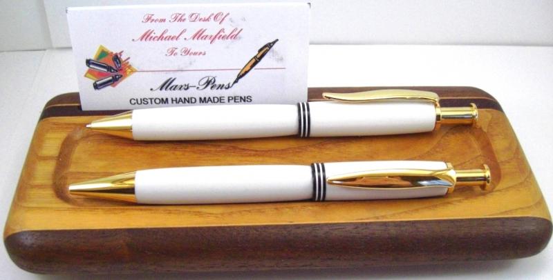

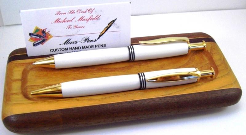

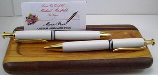

I made these for John (the desertrat) for Christmas :eek: (he already has them) :tongue:. They are a long click pen and pencil in gold. The blank is white PVC with two pieces of B/W/B pick guard for the center band. It was turned as one long blank and when I reached the desired size for the center band I parted a little off the lower part to create a step effect. It has been wet sanded to 600 then chrome polished and plastix polished.
Any Comments Welcome, and thanks for looking!! :biggrin:
HAPPY HOLIDAYS.

Dangit!!! Every time I get to think I really found some alternate materials or tricks you just gotta show me up.... Pretty smooth idea, though. I will now be on the lookout for some PVC to work with myself.
Max you are the MAN finish on these is exceptional. Many thanks my friend, they are now in my personal don't touch collection.
desertrat
John H
Great job Max, I really like the "faux" two piece look of that click. Had to look closely to realize what kit you used.
"I loke it uh-lote" - Lloyd Christmas
