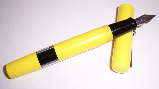

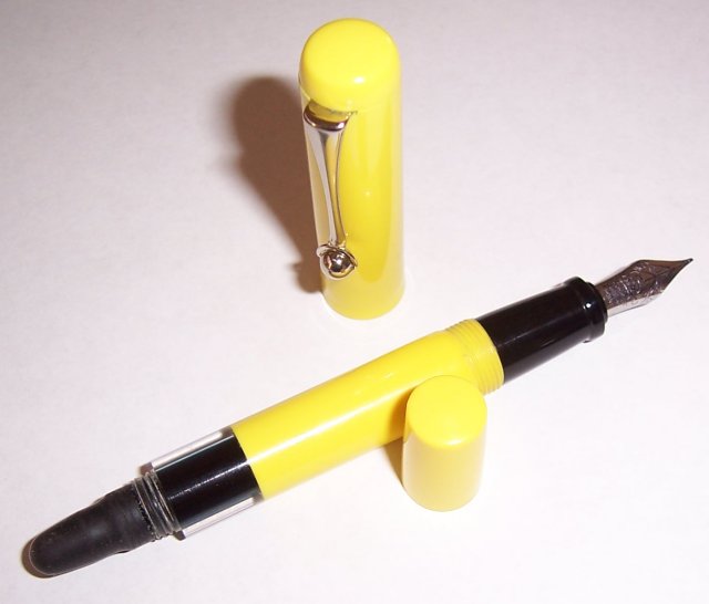

The reason I mentioned buying the rods AND tubes, is that the tubes make for dandy components to different styles of pens. Here is a pen with an ink window using the clear tube. Save on postage....... buy the tubes now, even though you may think you won't need them for a while! :smile:
This particular clear tube stays pretty clean too. This is my favorite pen and I've probably run a gallon of ink through it and it's still very clear inside when the ink level drops.
