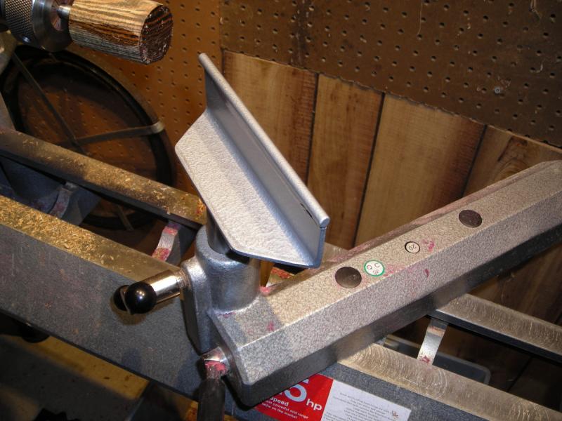

Shop made tool rest
It is a 6" piece of angle iron with the bottom corners cut off. I also epoxied a 1/4" cold rolled round stock to the top using J B Weld epoxy.
I had a friend weld a post to the angle iron to fit my lathe.
What do you think?

If you had your friend weld the round stock on instead of epoxying it I'd say it looked good. I don't care what J B Weld says I wouldn't trust any epoxy under turning stresses.

marcruby:
I am a bit nervous about the epoxy, too. I posted this in another forum and a guy from Robust commented about the epoxy that they use on their rests but did say that J B Weld would work. We will see. I will report back after I have put some time on it.
