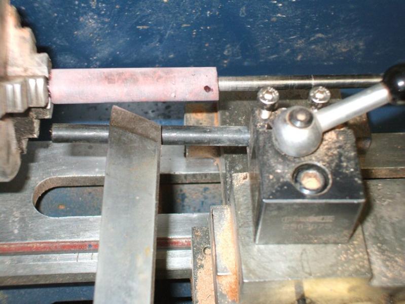

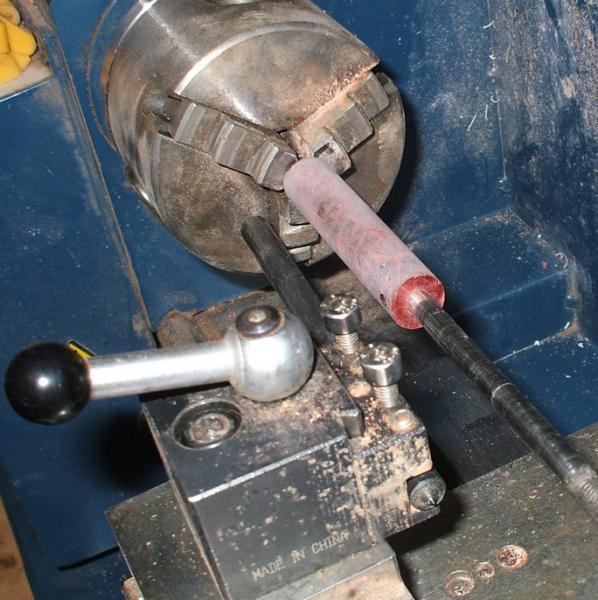

Here is a serious question/ Suggestion/ topic, for just such a separate forum. I woudl really like to use my 7X12 lathe to turn pens. this means a sturdy quality tool rest. I have the attempted version that you can buy that mounts in the tool carriage that you can get from Little Machine Shop. But it is a poor attempt at best. does anyone have a mod that works well or know of a way to mount a tool rest to or next to the machine so that hand turning tools can be used. If not are any of you tool making types up tot the task of dreaming one up. I was thinking of some sort of base that will replace the tool holder with a rest that can be adjusted up and down by at least a little bit. even a half inch would be good.
If you have a quick change tool post, you can change the height easily and quickly. I just use a round steel bar mounted in a tool holder. I ground some flats on one end so its a little more stable. Also have the LMS one that I never use.
Bruce can you post some pics of the setup?
Couldn't find my bar, but you could also use one of the HF punches as I did in the photos. Principle is the same.

Man, that's what I call lateral thinking!
I have had a hand turning toolrest on my "todo" list ever since I got my 9x20 metal lathe.
I have had my QCTP almost as long and it never occurred to me to use the boring bar tool holder (or a standard tool holder for that matter) for this purpose.
I can cross one item of my "todo" list, thank you.
