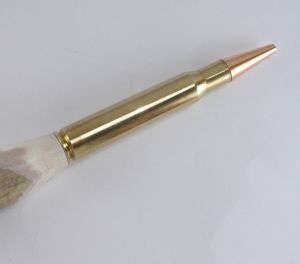

I use "Bright Copper" for the nib/bullet end. I use just gold for the rest of the kit. I use copper colored shells.
Here is an example,,,,,,,,,,,,

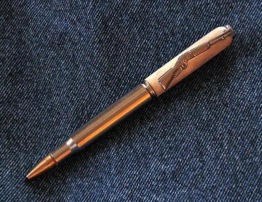

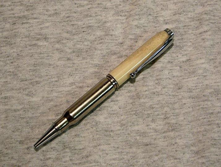

I believe you are talking about nickel plated shell casings. They are silver colored and are available in a variety of popular calibers. The 308 and 30-06 are probably most common and both fit a slimline nib pretty well on the outside (though you must shim the outside of the pen tube to take up the slop on the inside of the case neck). Or, if you use actual drilled out bullets for nibs, this is not an issue. I use chrome kits when I use nickel cases. The color match is decent, durability is good and the kits are inexpensive. Also, chrome slimline rifle clips & finials are now available from Bill at Arizona Silhouette if you like that look.
