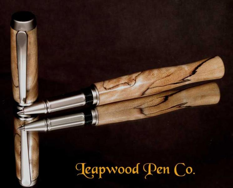

Ben the two pens I carry the most are one worth close to $30,000.00 which is a beautiful closed end Spalted Southern Magnolia Baron roller ball that has not unscrewed it's self in my pocket, [size=-2](the reason for the cost of the pen was two fingers cut off, one of which was sewn back on and 3 months of Physical therapy)[/size]
the other is just a run of the mill Ipe Baron Fountain pen which is inked with Private reserve Arabian Rose, which matches the wood color perfectly.
Unfortunately it doesn't go well with my dress shirts two of which have a pretty spot or two on the pocket, the rest of the time I carry a pair of JR Retros that have not decided to stain me.
I know that smart people use an O ring on the Barons that stop the caps from unscrewing but I apparently aren't that smart, [size=-2](really how smart could I be trying to stop a 10 in. 80 tooth blade with my fingers)[/size]
here's a picture of my 30 grand pen.
Damn, Ken, you gave me the shivers all over again just thinking about your accident!! That is a beautiful pen, though!

Ben the two pens I carry the most are one worth close to $30,000.00 which is a beautiful closed end Spalted Southern Magnolia Baron roller ball that has not unscrewed it's self in my pocket, [SIZE=-2](the reason for the cost of the pen was two fingers cut off, one of which was sewn back on and 3 months of Physical therapy)[/SIZE]
I know that smart people use an O ring on the Barons that stop the caps from unscrewing but I apparently aren't that smart, [SIZE=-2](really how smart could I be trying to stop a 10 in. 80 tooth blade with my fingers)[/SIZE]
