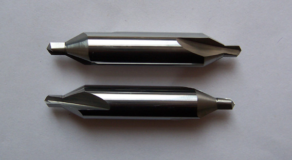

I normally use the double ended HSS bits. Like in the pic. I have never had a problem with them breaking and use them a lot on stainless steel.

But I found that I needed one size much more often than others and now get them individually. The ones in the pic are tungsten carbide but the HSS ones look the same
