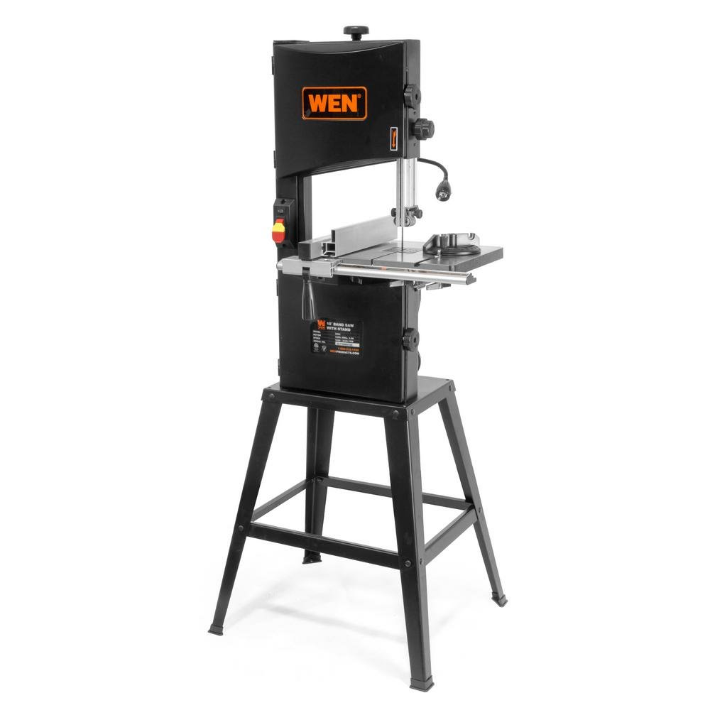

WEN 3962 10-Inch Two-Speed Band Saw with Stand and Worklight

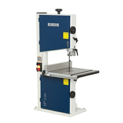

RIKON 10" Bench Top Bandsaw, Model 10-305
https://www.rikontools.com/product/10-305

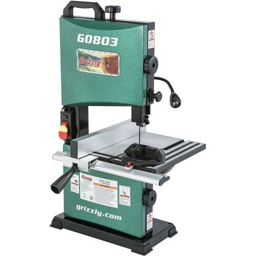

GRIZZLY-G0803 - 9" Benchtop Bandsaw
9" Benchtop Bandsaw | Grizzly Industrial

James; I just brought home a floor model used Jet bandsaw with a riser kit. It has a depth of cut about 12" so you can round out larger bowl blanks. All the table top saws are limited to 6" typically 5" and cannot be increased. With the riser kit, you need a longer blade length.
Go somewhere that has a show room (like Woodcraft, Rockler, etc) and get someone to show you all the ins and outs of using the tool, making adjustments, changing blades, etc. and see which you really like & will serve your purposes best.
I have a small 10" Craftsman workbench saw that I've had for over 30 years. It has served me well and I still use it to cut pen blanks to length and other things, but it's very limited for general use and a pain to remove the cowl to change belts.
I bought a floor-standing Rikon 10-325 a couple of years ago and I really like it. It has since been replaced with the 10-326 and while it's outside your stated budget, I highly recommend checking it out & comparing it to the 10-305 you're considering. The 10-326 is more rugged, easier to use, and doesn't require a riser to get maximum resaw capacity.
FWIW, I have never regretted buying more tool than my budget allowed.

The obvious differences are the closed stand & slightly more powerful motor, but check the blade guides on them. I believe the 10-326 uses the newer style that do not require tools to adjust while the 10-324 may still use the older style that require Allen wrenches to adjust. If so, that alone is well worth the price difference.
My 10-325 had the old style & the bearings wore out in a couple of years. The new style replacements had just come out shortly before my old ones failed,so I went with those & I really like them.
