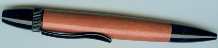

The kit is an Atlas kit from B.B. I liked the kit a lot. The wood is "pink Ivory" from another dealer. My question is, where's the pink? Is all pink ivory this shade of brown? I ordered Three blanks because I have never seen any before and to say I was disappointed in the color would be an understatement. I threw the other two blanks in a box in the corner.

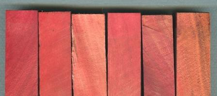

Pink ivory will run anywhere from a bright pink on a AAA grade blank to a dull pinkish brown on a C grade blank... what you get depends on the dealer you buy from... I only buy pink ivory from Ryan at www.woodturningz.com ... I am not saying that other dealers will give you garbage, but Ryan imports pink ivory, I got my first pink ivory from him and it was fantastic, he tutored me in how to keep the color when sanding and finishing... I see no reason to go to another dealer...

Don't feel bad,I was "given" 10 pink ivory blanks as an appeasement by the mangaer of a Woodcraft because a 3 hour round trip yielded me a broken lathe out of a sealed carton.
6 had no pink color whatsoever.
I have also had some that contained only streks of color.
Those were nice but not what I excpected.

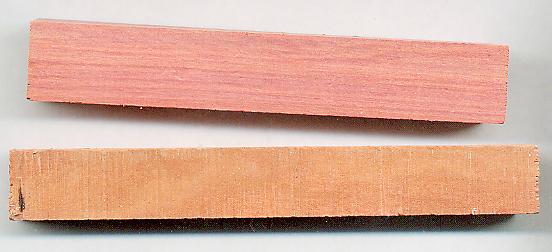

My local Woodcraft store had some Redheart that was as pink as some of the pink ivory that I have. I bought a small batch of the redheart for just that reason. Kirk[8D] The top is actually redheart and the bottom is pink ivory.
