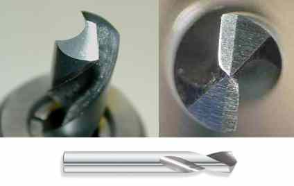

Try using a spot drill instead of a center drill. For copper or brass, stoning a flat on the normally sharp cutting edge will greatly reduce the tendency to grab.
