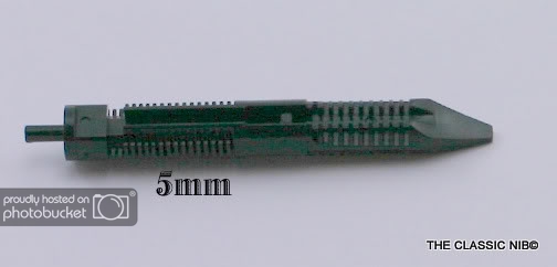

The problem that I have at the moment, is that I would like to find a person or a company who could supply me with a traditional nib unit with a feed that has a 'groove' that feeds the ink just like the old fashioned feeds in Vintage Fountain Pens.
The problem that I have come across, is that if I try to use a Bock nib unit in a pen that I want to function as a button filler, sometimes the rubber sack 'comes adrift' from the collar at the back end of the section, obviously the pressure is too great to force the air, or ink through the incredibly thin groove that is the 'feed'. I realise that the feeds that people like Bock use are designed to be used with Cartridge/Converter units, but I would prefer to use a more traditional feed.

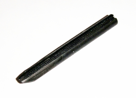

Henry - not sure if this is what you are describing.
attachment.php
One of our members from South Africa got a few of these for me for some very small vintage nibs. His screen name is TerryF - a very friendly member. He may have a source who makes them. Send him a pm, mention I sent you and see what he can do.

Henry, I have Bock 5 MM feeds and the ink channel is wider and deeper than mostand also runs all the way to the tip. Be happy to send you a couple along with nibs to see if they would work. Roy, Here is a photo:

OKLAHOMAN, I can see from your picture, that I have tried to use this type of feed [and presumably the Bock nib that goes with it,] and the problem is that the little pipe sticking out the back end of the feed is too small to suck ink in, or blow it out when the push-button is pressed too vigorously; with a cartridge converter, there is a much slower 'descent' and 'withdrawal' of the piston, and the joint between the 'piston' mechanism is supported by the other tiny tube which is attached to the nib holder and completely covers the pressure area.
