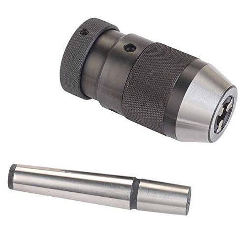

Is it a 2 piece jacobs chuck like this??? What actually came off. Did you seat the taper deep enough into the tailstock?? Sometimes you need to clean them out. What cused the blank to blow up?? Did the bit wobble because the chuck was loose??? Need some more info.
Sounds like the drill chuck came out of the tailstock, or came apart as JT's image shows.

Sue when you say it came off the taper. Which taper??? Did the whole thing (both pieces) come out together from the tailstock or did the chuck come off the spindle???
If the entire chuck came out of the tailstock then try to do as others have suggested, as you drill just hold onto the chuck as you drill and also as you pull the drill bit out. If the drill spun on you as you were drilling there is no way that chuck should have come out of the taper. It would just spin and you need to watch that it does not mar up the inside of the taper. Usually as you drill that taper seats itself even tighter in the tailstock. It comes loose when you pull the bit out of the piece you are drilling. As mentioned need to check that the taper is clean both on the tailstock and the chuck shaft. Also make sure that chuck is seated tight in the taper. very easy to have the tailstock run up too far.

The one thing that needs to be noted in this type of chuck there are 2 morse tapers on the j33 arbor so a draw bar will only help to a point.
Small correction John. One Morse taper, the long one and the short one being one of the "j" or other series tapers.
Sue. When you're ready to put the taper into the chuck make sure it is not galled or scored and still straight, otherwise get a new one. Wipe the two taper surfaces clean with solvent, acetone will do, and put them together holding the chuck up and the arbor down. Tap them on a bench and then slam them hard once or twice on the bench so the inertia of the chuck stopping seats it. That should keep them together in the future. Tapers come loose from vibration so keeping a steady force on the taper keeps them locked in place. That's why so many are recommending holding the chuck while drilling.
Basically there are 2 tapers. One short and one long. To really lock the short taper to the chuck you can use the old adage heat and cold expand and contract metals. Stick the arbor in the freezer for about an hour and that will shrink the metal. Now you can get crazy and heat the chuck but I would frown on that because of the lube in it. Take the arbor out of the freezer and insert in chuck and hit it with a brass hammer or a piece of wood and a dead blow hammer. Have the chuck resting on a piece of hardwood. This will lock the arbor to the chuck. One less thing you have to worry about coming loose.
As you are inserting the taper into the tailstock give it a twist on that final push.
