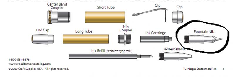

This sucks, I bought the nibs because in thier diagram they labeled the feeder + nib as just "nib. now I have a fountain pen with no feeder, where can I buy one that isn't over the web? Like staples?

On their website there is a place to purchase just fountain nibs BUT they show only the nibs without feeds. Where is this diagram you are talking about that shows the nib and feed together? Could you provide a link to the page, I would like to see it.
As others have tried to tell you, the only way to convert a statesman rollerball into a fountain pen is to have the fountain pen FRONT SECTION which holds the feed AND the nib. Craft Supply has never sold the front section seperately nor the feeds. As suggested, to do what you want to do, you will need to buy a fountain pen kit and take the front section/feed/nib assy out and the whole assembly replaces the rollerball nib section.

I did not mean to cause any discomfort or false accusations, this was what I was talking about when I stated I was ill-informed. :confused:I'm still new to pen turning and when I saw this diagram I though buying a "ni" would suffice. Due to the picture blending the feeder and nib together. I now know that was wrong. Again, still looking for a site that sells the "ni+feeder" combinations that fit a

Dan, thats called a complete section, consist of nib,feed,feed housing and outer section. No one sells sections you need to buy a complete component set, sorry for the bad news.
