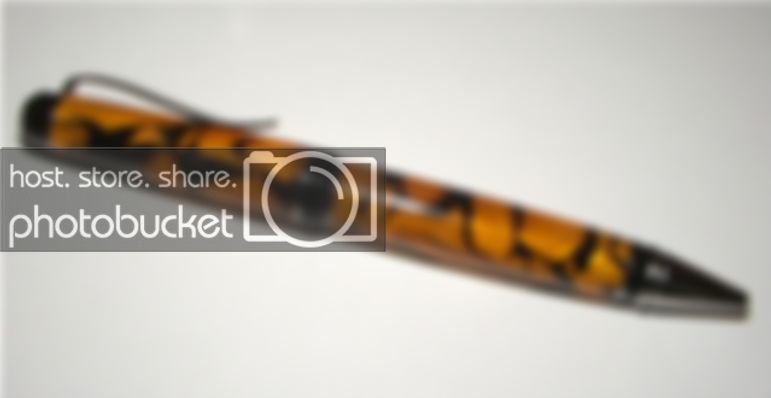

Just to give you an idea of what I am talking about here is the latest cigar that I am not happy with. What do you think??? I know my photography needs work but that is something I will work on at a later date. Have so much on my plate right now. Looking for critiques. Thanks.
JT,
I like the shape of the bottom of pen but for me the top looks good if you keep the same diameter as the lower bushing most of the way up the top then just roll it over to match top bushing.
Ken your shape is almost the same as what I have from what I can see.
Dion I agree with your concept in shape.

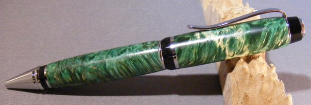

Here is the shape i usually use.
Ken,
I have not seen some of your pens before. I need to get my head out of the sand. There is a balance that is just right in segments that really make a pens stand out and you have achieved that on several as well as the one in your post above. I have done a few like that and true to this thread, there is something about just the right shape and or balance in segments that make it stand out even more than just the colors alone.
I like your pens.
The one you posted works fine for me. That's about how I want it. Some people like to curve the upper barrel inwards, and if you do that, the clip doesn't work well. I do not like it to be too fat and pregnant. It's a pen, not Lucille Ball.
JT, I like the bottom, but if you'll notice where the top of the lower tube contracts the center coupler, this is a very hard spot to get just right, to really get the shape, you have to under turn it just a bout .010 to let that radius of the coupler show, I do like the shape of your lower tube, but I like just a little bit of very gentle bulge on the top near the center, and blend into the finial, but yours is a nice looking pen for certain,
You are right Ken. There is just something in the top part that is not quite to my liking and will have to try your idea on the next one. I will keep tweaking. It is in there somewhere. Thanks everyone for the ideas and the comments.
