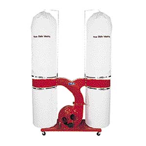

I know I'll get a lot of differant opinions on this, but here goes: I need to buy a good dust collection system for my shop and I would like to know which is best, the cyclone type or the standard two bag dust collector?
I'm also talking about a two HP or larger system.

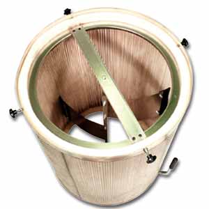

I have the Jet 1200 CFM, 2 horse. I've added the canister filter and noticed a BIG difference. I'd suggest whatever choice you end up making go with a canister filter like this example from PSI:

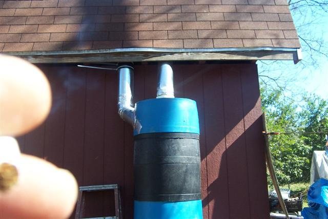

One question for those "touting" the paer canister type?
The filter WIll get clogged.
How do you clean it?
What are you breathng WHEN you clean it?
I use a haome made separator made from plastic barrels.It stands 8 ft. tall because I ranout of six inch duct.
I have not had a need to empty the cloth bags in over a year.
Total cost for the gome made separator?
Less than $25.00.
I empty the separator with a Leaf hog once a year.

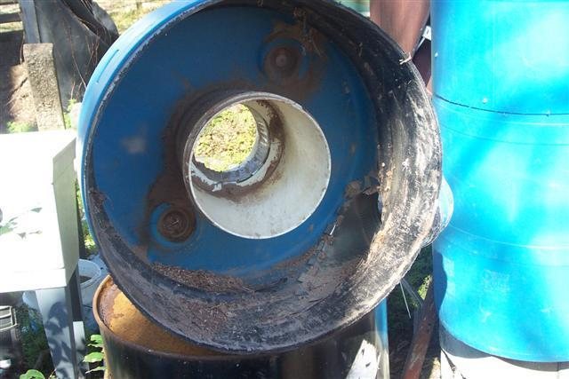

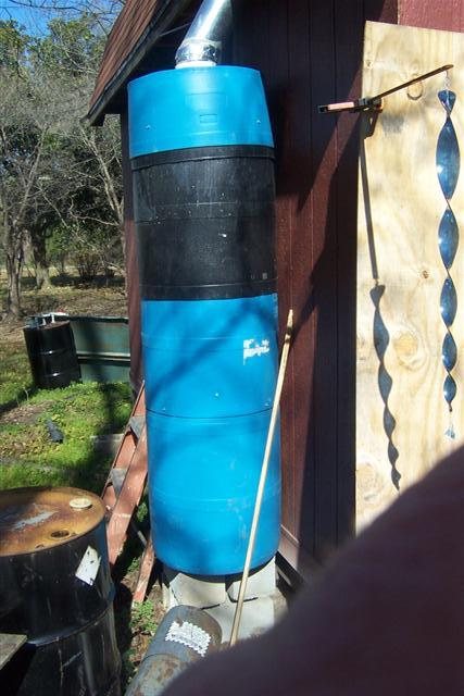

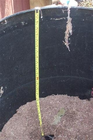

Originally posted by Paul in OKC
<br />Eagle, you mean similar to one of those swirly things you stick on a trash can or 5 gallon bucket?
Nope mine is on steroids.
Never buy what you can build.

I leave everything sealed up (plastic bag on the bottom) and blow between the pleats with my air compressor. It all falls down into the bag first. I am NOT using a paper filter, mine's woven fabric from Wynn Environmental. They say you can spray it with water, and it will withstand 200psi of compressed air blown on it.
I'm breathing air WHEN i clean it :D
My plans include a cyclone in the near future, but for now that cartridge filter is usually 10x better than the bags that come with most systems. The surface area gained by upgrading to a canister filter is incredible, I don't ever plan to touch another fabric bag again. In my mind, those fabric bags are useless - anyone want my old ones? :p
