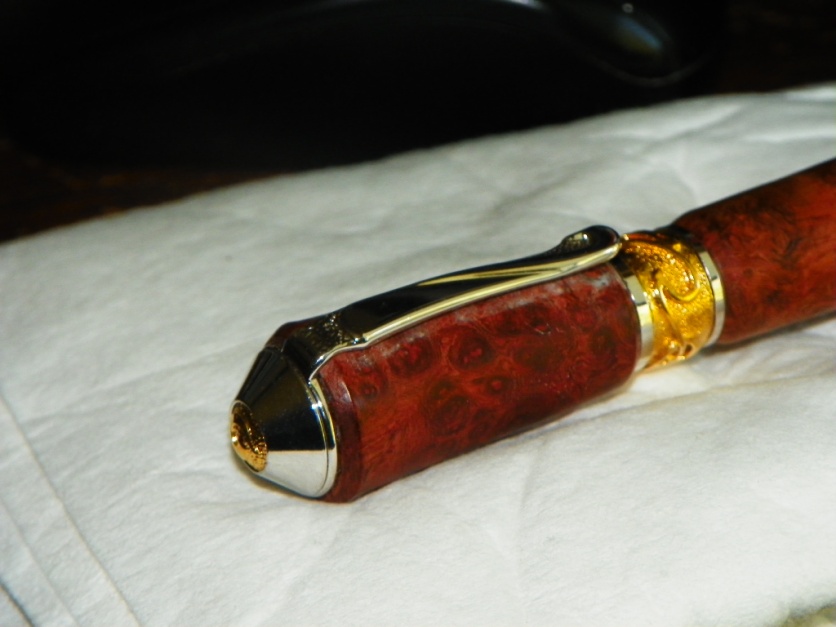

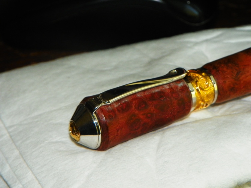

I made an Art Nouveau pen with Amboyna blank about 5 years ago. Ever since its been sitting in my Pen storage box, never used. I look at the pens about every 4-6 months and this one pen keeps getting a white mold-like substance on it. I have tried just wiping it off and waxing or polishing it as I sometimes do the other pens. Doesn't make any difference.
It's placed next to an identical Amboyna A. N. pen and no problem with that one or any of the other wooden pens.
The wood was well seasoned when I first turned it/them. I'm curious as to what it might be. Toxic? non-toxic? Any ideas?
Russ
Is there any way you can provide pictures of this? I too am curious on the type of finish you used as well
I finished both with sealer(all my wood pens), then finish off with Shellawax, after sanding and burnishing to 12000 grit.
Sorry, I wiped off the stuff before thinking.
Russ
This image will show what is left of the stuff after I wiped off. I didn't get the amount beneath the clip.

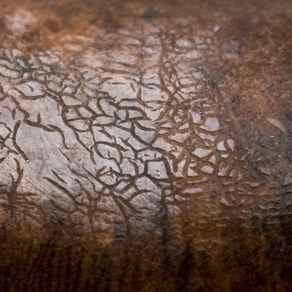

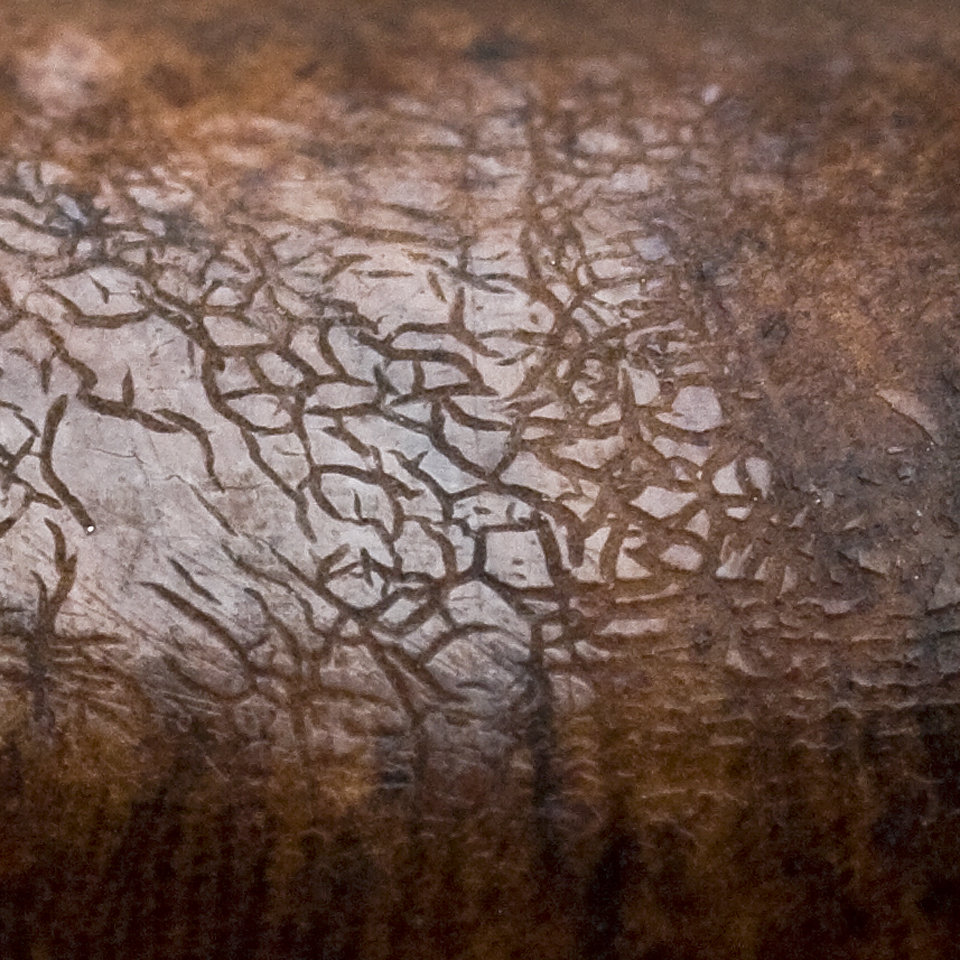

Here,
This is a close up. From visual distance you can not see the valleys or the ripples that is happening
attachment.php
This is a sierra that I did back in 2008, about 5-6 months after I finished the pen started changing into this. I left it alone until later and I guess now is later :) Oh and yes it was flat and shiny when I was done with the finish.
This may not be the same cause/problem that the OP listed but from the photo posted and description it is.
