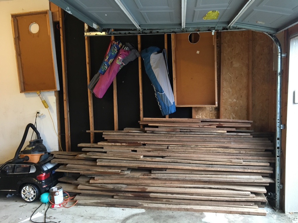

With approximately 480 board feet of walnut that has been air dried for over 50 years? :biggrin:
attachment.php
I'll let you know when I pick it up. Merry Christmas to me!

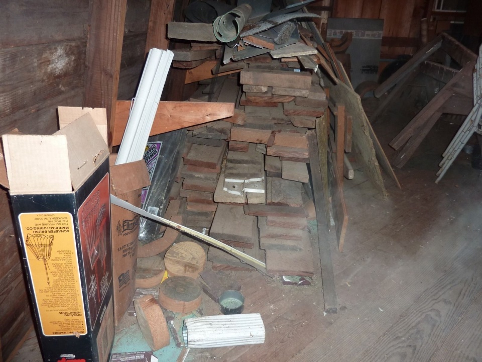

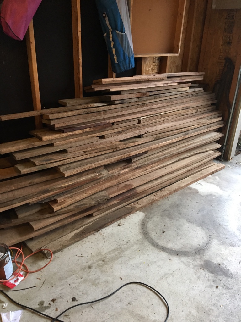

Well. I collected it all today. I guess I should have clarified about it with the seller though. It was in his barn, up a 30ft incline. Thankfully my younger and in much better shape agreed to come help me or I wouldn't have made it. As it is I'm in severe pain after sliding in the mud and almost doing a split. I also picked up a delta planer from the gentleman, still in its original box. He claims it was used once and I believe him! I'm very happy with the deal I got. My wife is not. I'll be cherry picking the boards I want and probably Craigslist for the rest of it.
Is that your version of a Roomba for the shop in front of the walnut in the last picture?
I would keep every last piece of that wood, especially if it was from the same tree. Last time I looked a long time ago, Walnut was well over $15Can a board foot, but having that much wood will allow for some nice furniture to be made with lots left for smaller things like end tables to jewelry boxes and then down to pen boxes and pens. Your decision though. Enjoy.
I am with Pete. I would never give any of it away. There are a ton of projects I can make with this. As I sit here drooling. :eek:
At least you got your car parked in the garage:biggrin:
Now that you have a planer as well, don't go ruining those blades just getting a look at your new walnut stash!
Take each board out a few at a time and hose them down (in the spring after it warms up) ... while wet, take a deck brush to them and scrub all that dirt off of them. Flip them onto some stickers (thin strips of wood to get them off the ground or driveway) and scrub the other side ... bring them in to stack and dry again, on proper stickers for air drying.
Once they are cleaned up and dried again (give them a week or so in the garage, at least), run them through the planer to remove the surface wood so that you can look at the grain figure and check for spalting, knots, splits, checking, cracks, worm holes, ect...
After all that, you'll wanna make your choices about which ones to hang on to and which ones to sell off.
Also ... don't leave us out of the buying! Especially if you're gonna take some really nice figured or spalted walnut and make pen blanks to mail out to us! :)
I would never wash them down. No water to dry boards. Stiff brush and you are good to go. Not sure how they were milled or what the history is behind them but need to make sure there is no metal embedded in them. Do not plane unless using. If you want to see a certain board just skip plane it. When you do plane a board make sure you plane both sides evenly rotating them. The board will have less of a warping chance that way. Do not expose a fresh board if not using it. You will go through a few sets of blades but there is no way around it. Depending what planer you have it is easy to sharpen planer blades yourself and it is also possible to get some carbide replacements.
Sticker stack properly for even air flow. Have some fun and make us all mad at you as you show us each and every project. If you are going to make pen blanks make sure the board is of pen blank quality. Also leave blanks as thick as possible and do not plane to 3/4" This all is of course my personal opinion so do with it as you wish. :smile: Good luck.

Mmm ... yeah, I should be kinda leery of putting water on those boards, but the dirt and grit in them will surely tear up planer blades like nobody's business... :(
Washing them to get the worst of the dirt and grit out will only take you some extra time to properly dry them back out afterwards, so long as they aren't air dried improperly and allowed to warp.
Not a Problem
Justin, my son-in-law will be by sometime this week to help you sort through the ones you don't want.:biggrin:
I'm with John on not washing them off. A fine brass wire brush followed by blowing with compressed air. If the planer is one that has disposable blades, keep a set to skim with and finish with sharp blades. Next time you have another project you put the dull blades back in for the skimming. My planer is old school in that the blades are sharpened and I ran some ugly wood through it with only brushing it off. Like turning there are many opinions on how to get the job done. Take the time to read a lot before you start embarking on a project with such a nice resource. I'll add that you should be flattening the first side on a jointer and then thickness to project size, otherwise whatever twist, bow or wave remains.
These boards are old. The gentleman I got them from is 86 and he said he's had them at least 50 years, and they were in his grandfather's barn before that. I'd guess their every bit of 100 years old. You can tell they were sawn on an old rotary sawmill, the old fashioned ones with the big 4' diameter circular saw blades. The very rough texture would actually probably sell very well with the hipster "reclaimed" look everyone wants nowadays like this.

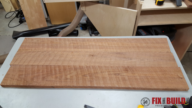

Oh yeah, those three boards are beautifully clean and you can see the grain pattern in them clearly .... no need to plane those before use or sale!
I saw a lot of dirt from the side in the previous pics, and the dirty ones will need a good cleaning.
If they're mostly clean like the ones you just showed, then you should be good to go with selling off the stuff you don't wanna keep, and possibly getting rid of the dirty ones too. That would mean that someone else would have to deal with the dirt and grit in their planer, not you. :)
That picture is just an example of old walnut that has been hit and skip planed to leave the radial saw marks. It's not my picture or my wood but I would expect mine to clean up the same. They aren't really dirty, just mainly dusty from long term storage.
