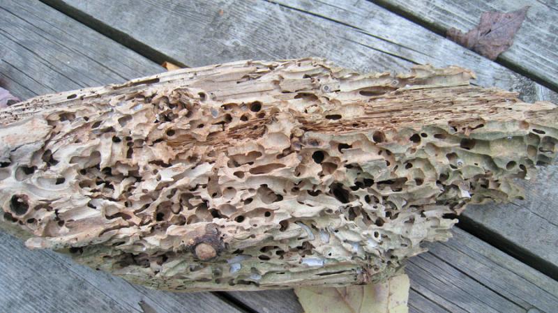

Got another chunk of wreck wood a few weekends ago..
Not sure yet which its from as three went down in the exact same area..
H.M. Alert in 1791 (schooner)
Gipsey 1850 (brigatine)
Clausina 1850 (bark)

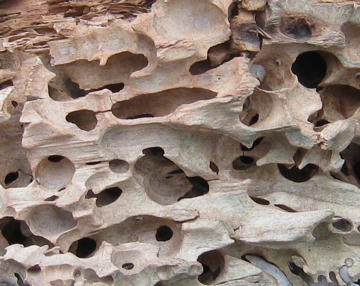

Soaked this and cleaned it very well in boiling water to clean it. What would be everyones approach to make it into pen material using Alumilite?
Cut into blanks then cast?
Cut into a block to fit the pressure pot then cast?
Or??
There was an even nicer piece I was trying to get but it was wedged VERY hard under a very large rock, couldnt even budge it and running out of time. Maybe next year :)

With that many voids, you will get the most complete fill if you cut into close to blank size before casting. Be aware that wood like that has become very porous and will most likely discolor with the Alumilite. I would probably suggest that you cast it in clear and then paint the tubes to get the best effect. This will highlight the wood best and not make it blend with the resin.

Thanks Curtis, would letting it soak in some kind of wood hardener help first for a while before casting it? (and allowing me to do other colors?)

Soaking it in some kind of hardener sounds like a really good idea. You can probably use colored resin then. Cutting it in at least 1" slabs before casting is probably also a really good idea to maximize penetration.

Started to cut it into slabs today.. shes pretty soft. I think I better stabilize it first and then cast it. If I cast it as is, the wood would be pretty soft and would chip out a lot I believe.
I've cast some wood with lots of voids like that and it helps to pour the resin in fairly slowly and try to have the mold fill from the bottom up. I usually start pouring in open areas between blanks or on one side and let the resin flow into all the voids.
This way helps displace the air from the bottom and leaves room for it to escape from the top instead of pouring from the top and trapping air bubbles in the voids.

I'd be worried not so much about filling the large voids as getting the resin to
penetrate into the wood itself to get some adhesion. Perhaps alternating vacuum
and pressure? Thinning the resin? I'm not sure. Looks like a challenge.

Use alumilite. I've never had problems with it adhering when making WW casts. Label/snakeskin casts, yes, but no problems sticking to wood or shrinking away.
