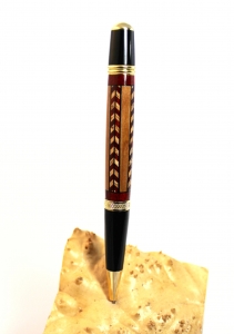

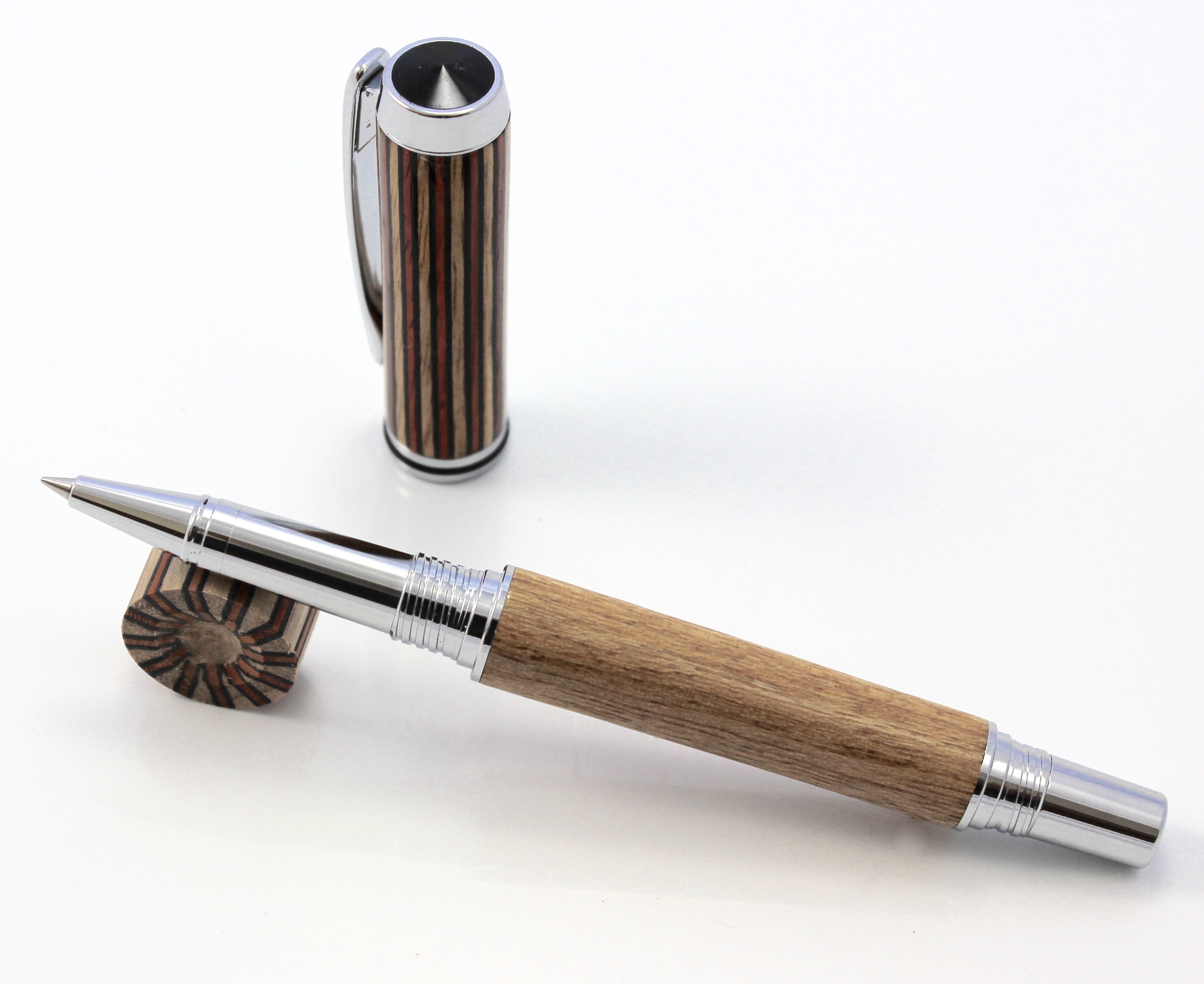

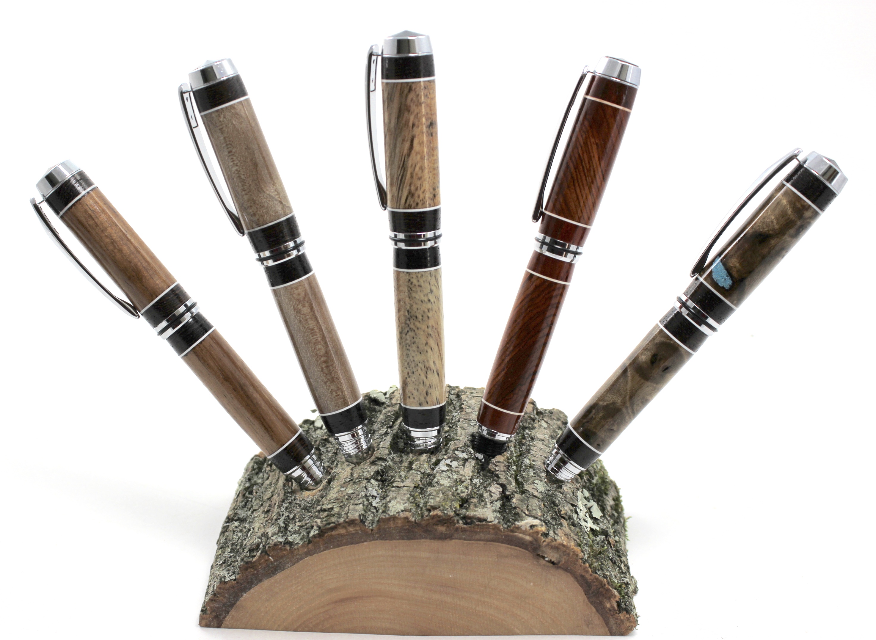

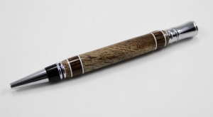

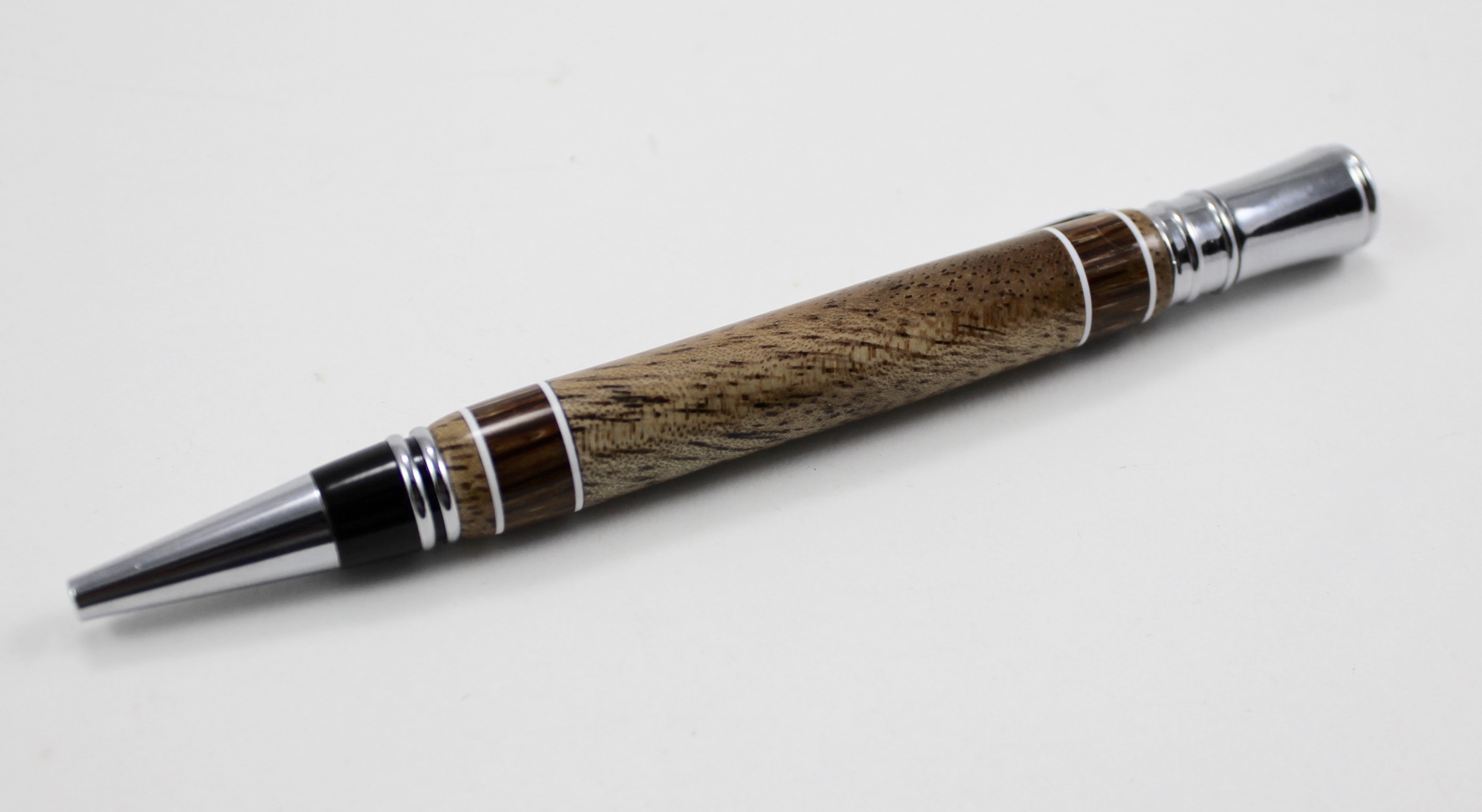

If you are just getting in segmenting, consider these designs (My pens, but some of my designs, some others. Some are nice, some need refinement). Ask any questions or PM me. Have FUN!
It's a big black hole, wanna jump ??? Some like segmenting, some like a nice grained simple blank...I like BOTH!
