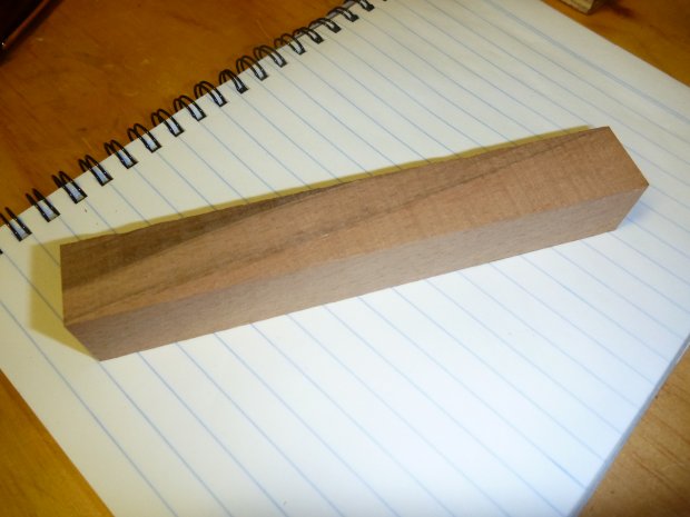

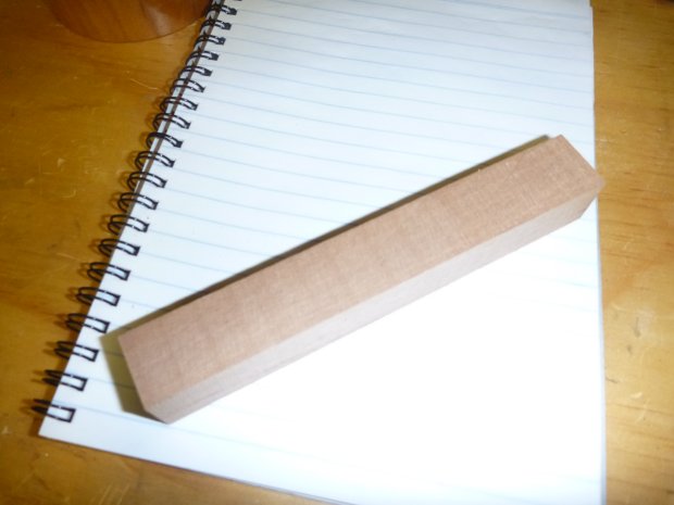

Hi Ive got a heap of these blanks that I purchased in a length of timber labelled "black walnut". The grain is tight but the blanks are light. They look like they will make a pretty boring pen.
I'd love to know what you guys would do to get a more impressive finished product!

Maybe use for experimenting,like dying with food coloring?
I got some pic guard material and want to learn how to do it,but hate to ruin nice costly blanks so I plan on using cheap,boring blanks as "learners."

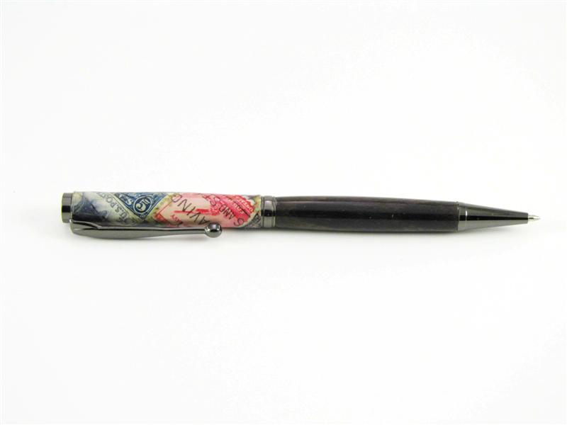

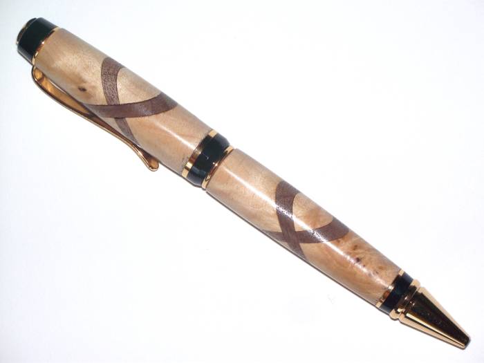

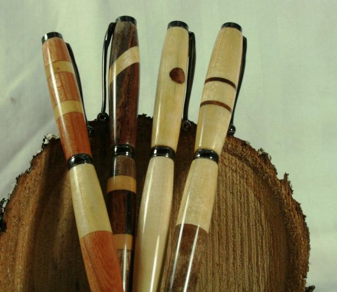

You could do some cutting apart. Here's a few pens I've done. These were done with birch with walnut.
There are SO many things you could do... whatever you can think up.
Good luck!
