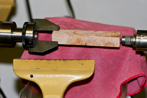

I got in a hurry one day - a customer wanted to meet for coffee and see some acrylic blanks to choose from. I wanted to round them out so he could get a sense of what they would look like rounded. Instead of putting them between centers and rounding them out I just threw them on the Drill Chuck, clamped them down on the end and rounded about 3/4 of each blank.
Well, some of the work I do requires precise drilling to line up the grain or "lines" perfectly and doing this with the Drill Chuck did really messed it up. The jaws now have a lot of play in them and when I insert a blank for drilling all the way in on the jaws, it's really only tightly grabbed by the jaws closest to the headstock. I can wiggle the blank out near the end of the jaws.
This is a $75 chuck. I know it makes common sense to me now, but it didn't seem to matter to me when I was in a hurry. It will still work for a general kit pen, but I had to order a new one for use with precision projects. Uhhg!:mad:
Don't do what you see in the photo! Hope this saves someone else $75

Well, ok then! Glad I haven't tried that yet...can't say that it hasn't crossed my mind though.
I thought this was going to be one of those, "I-chucked-my-drill-chuck-across-the-shop-and-it's-stuck-in-a-wall" topics....whew!
No way of being able to get the 'sloppy' out?
Scott (expensive lesson) B
I don't think so. I think I definitely bent something. I ordered and received a new one and it's tight! No play. So I definitely screwed it up. They are made for drilling, not for turning!

I have the same problem with my PSI chuck. HOWEVER, I have to take the blame. Something about RTDM! :mad: I just started out using the chuck and didn't put the blank all the way in (kinda like your picture). It appears to have bent the jaws. i still use it, with the blank all the way in and the jaws seem to hold it adequately if I really crank the jaws tight and the hole is drilled accurately. But I'm sure they are weaker than they should be. As long as they hold when I bottom out the blanks I'll keep using it. The chuck is a great idea and still beats drilling on a drill press. +1 on drilling a starter hole, too. HF has good cheap starter bits. Give it a chance if it still grips.
gordon
