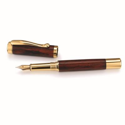

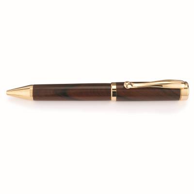

Ok here are the kits I'm leaning to. Note this is a High School Graduation gift and I already have the bushings.
Continental Fountain Pen Kit Gold
and
Continental Ballpoint Pen Kit Gold at Woodcraft.com
That ballpoint kit is the same as the Berea Atrax, I believe.
The Schmidt 2006 pencil mechanism works fine in the Berea El Grande. Not sure about Atrax.
Might be a good idea to ask Berea.
