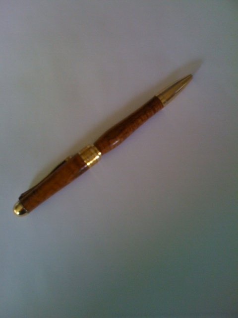

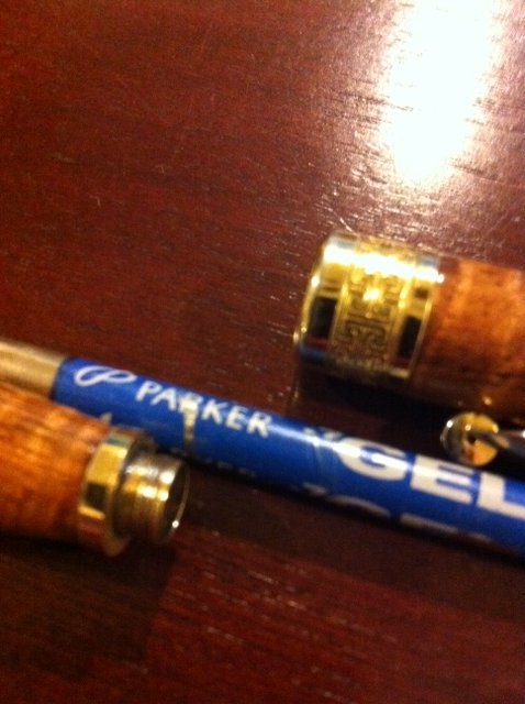

BUT, the one thing I can't figure out is what the kit is for the pen my wife originally bought for me. I'm attaching a couple of pictures in the hope that some of you experts will recognize it - and perhaps know where I can buy it.
Thanks
Chuck

pictures are a little fuzzy but I think it's a frankenstein kit.
Finial looks like a euro
Centerband a euro designer
transmission looks like an 8mm or one that some cigar kits use
nib almost looks like polaris type
the clip is a roller clip that I don't think is standard on most of the kits.
You might check with Aaron from LauLau woods. He's a member here and it may be one of his pens that your wife bought.
I've disassembled to pen enough to be able to tell it is 8mm. The drive mechanism is in the upper end and is of course a twist transmission. The lower part of the transmission is threaded with female threads which couples up with the male end protruding from the top of the lower portion of the pen. Does this sound like a standard cigar pen set-up?
I've spent the last couple of hours trying to locate a distributor of center bands where I can make a match - with no luck yet. It's not a Greek key pattern. It seems more Asian in its appearance. Any thoughts of the best distributor for center bands and other odd parts and pieces?
Thanks
Chuck
That center band looks a lot like the CB from the Olympia that Arizona Silhouette has listed. Probably used it on a Neopean from Lau Lau since the upper barrel of the Olympia is "O" just like that of the Neopean.
What do I win!:biggrin:
Ghostrider - You did indeed find the center band. I've spent hours looking for it. I just bought some of the kits just to get the CB. Any ideas on a good source just for center bands? Also just bought a couple of the lau lau kits. I'll see if some of these parts can be mixed and matched......
You could try to adapt an "Elite Band for Euro/Designer Pen" that I found at Woodn'whimsies. Penn state also sells them. It isn't the same, but it' difficult to find individual parts like that.You'd of course have to find a way to make it fit the transmission (using 8mm or "O" tubes will do this). The CB that comes with WNW's Euro doesn't require a 7mm tube, so it would work for 8mm. You just have to cut the tenon to the proper diameter. WNW also sells 8mm tubes.
AS is the only place I've seen that particular component set. You may have to mix and match if your set on that one. IF you do, you can always sell me the extra tranny's and adapters.:biggrin:
