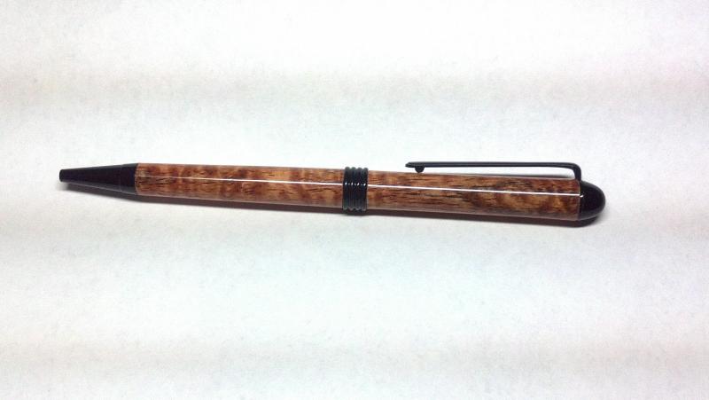

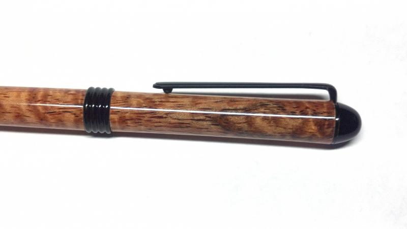

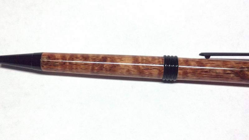

Did several pens today, and I have one that I made from some blanks that I bought about a year or more ago, and I didn't write down what the blanks were any one know what this wood is?

Sepele or afzelia
I've turned a bunch of both and they look almost identical. Both are species of mahogany, which match the color and grain pattern. Could be koa, but the color is a little different than most.
