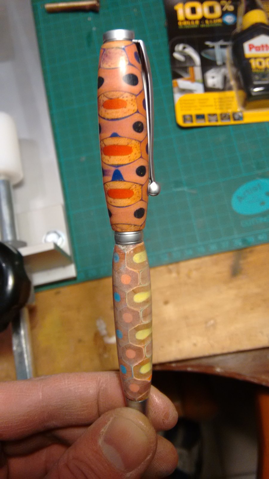

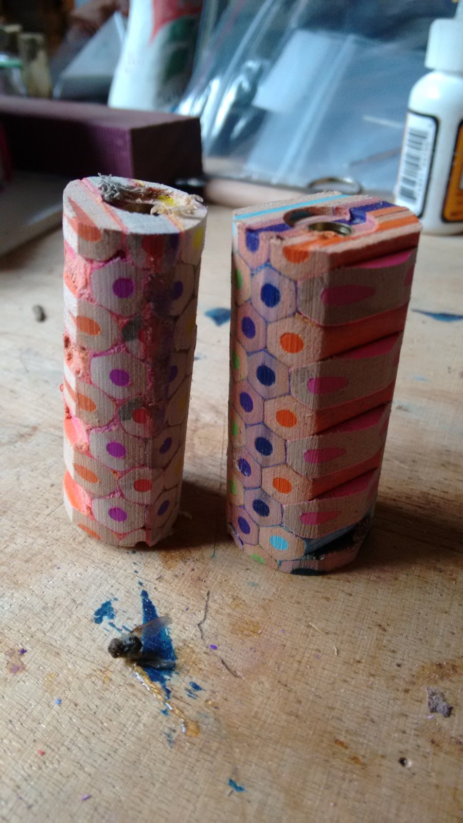

i had this problem with my segmented blank made of 12 colors drawing pens. the density was different between the wood and the pencil lead, so, i really had to make the round shape manually on a grinding machine with a 80-120 grain sandpaper.

i love crazy shapes, the weirder the better, but i oftenly have to break the angles in order for my pen to be agreable to write with, and depending on density, the less dense the simpler the shape.
I also use some metal thread to "burn" the wood it's giving a nice natural result, no colors added.
