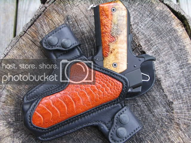

Tony, where did you get amboynia? I have 3 Dan Wesson 1911 firearms with Amboynia burl grips and would like to get some pen blanks to turn to go with my guns.
I live in Lithia Springs not to far from your local in Alpharetta so we might have to get together sometime and share some turning experiences. I am brand new at it and just now getting a shavings pile going on!:smile:
I sure would like to be able to make a pen to match the grips on this gun.
I have two more guns with grips by the same artist and he picked out the wood for this one based on the looks of the other ones I already had. I realize that you may not see many pics of firearms on this site put I put it there for reference only and if it offends anyone I will remove it.
