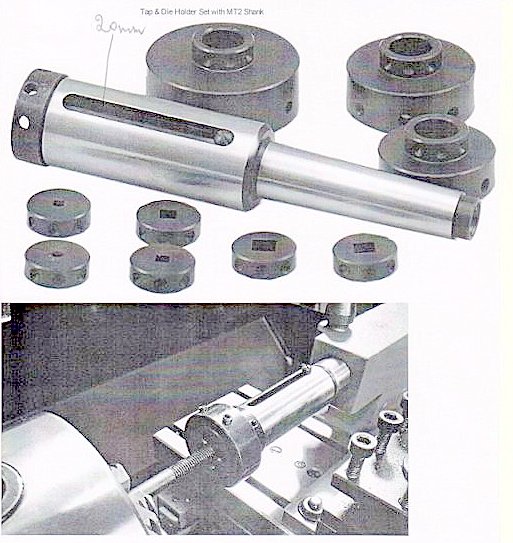

Morning here , my better way was to purchase from Ausee on the internet this comprehensive set. Sorry for the quick pic from the catalogue.
There are several adapters that fit on the outboard end that cater for all sizes of button dies with a real bonus of recessed slots for taps to fit in of the common sizes.
I undo the small set screw to allow hand threading for pen use.
Works for me.
Peter.
Works for me.
Peter.
That is slick! I've not seen those. And I need another die holder because I just bought the 14mm triple start die. I have the adapter from Rick Herrell, but I want another die holder so I don't have to switch them around!

I just rang the company located in Melbourne Australia, on the internet they are ausee tools,the listing is under taps and dies, my price was around 74 dollars AU plus aussie freight of 11.50 to Canberra.I made my own previously die holder (piece of cake really but taps are another big deal, its neat to buy so cheaply IMHO.
Kind regards Peter.
