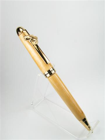

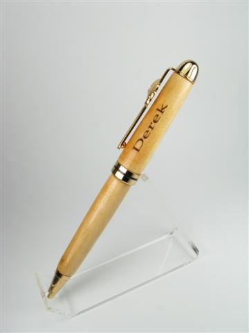

Here's a pen turned from Basswood to give you some idea what it looks like. It can be easily dyed any colour to provide some attraction.
This was for my SiL who fancies himself as a Bass fisherman!
