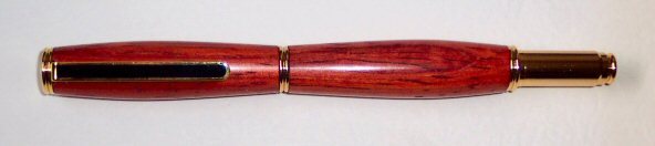

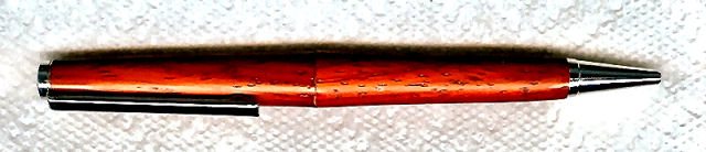

When I made my first Padauk and finished it, the first thing I thought of was sending it to my niece's husband who is an alumnus of UTn (not Tx [:)] ) and a huge fan, supporter - he lives ORANGE!
I liked the Padauk pen so much, I decided to keep it and it is the one I carry around all the time. I will soon make some more Padauk. Some Padauk have black streaks in it (as mine does); but there are some with more even grain.
The pen below is a little dark and some Padauk is lighter, but it can give you a general idea.
