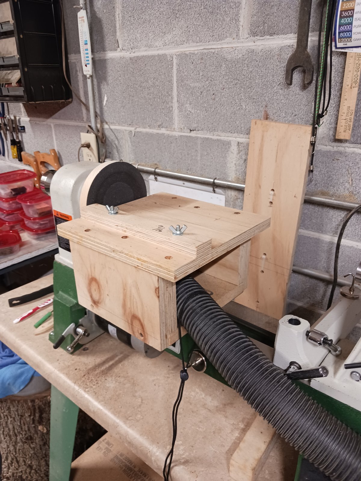

Here is what I made for sanding but use a pen mill for blanks. If there is a lot of material past the tube, I run it through the bandsaw.
