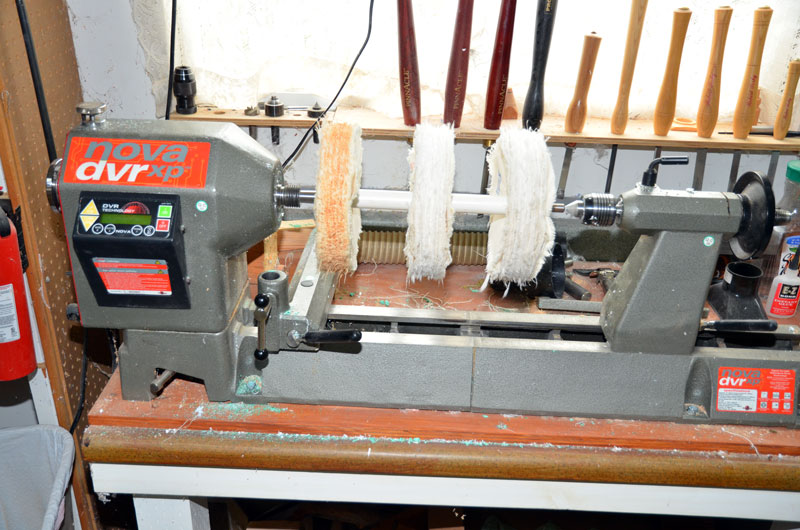

Wood craft sells a box kit called "The Beall Wood Buff. it comes with a single holder for the 3 8" buffing wheels that come in it. It includes 1 stick of tripoli, 1 stick white diamond and 1 stick carnauba wax. I always use tripoli filled by white diamond and have a scratch.
I do wet sand first to 12,000, but really no need to less will work fine. My pens shine really nice. That said I have not tried it on CA only acrylic. But several friends of mine do there CA that way and are ver happy. You will have to get a adapter for the head stock.

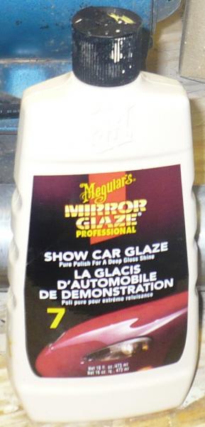

after MM, then buff off lathe with McGuire's Mirror Glaze; Show car glaze #7. Then Ren wax. Gives a deep, glass like look.
