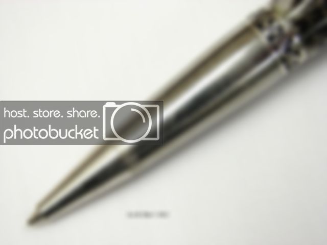

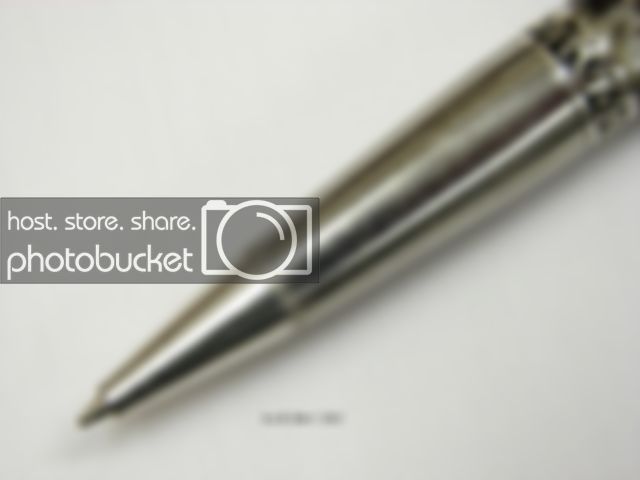

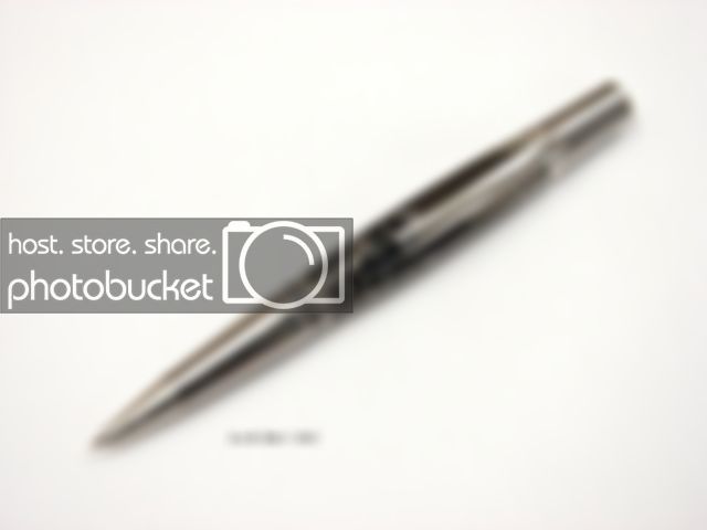

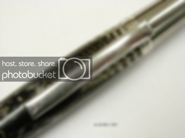

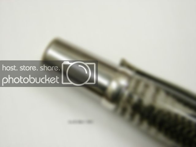

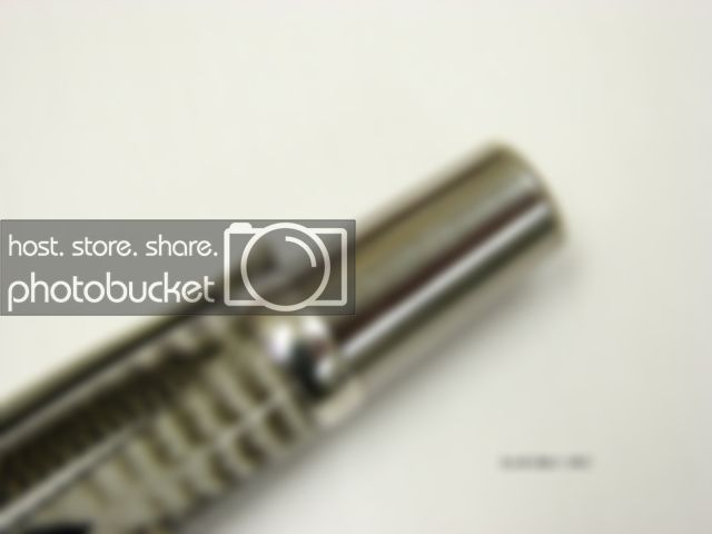

I sold this Berea Sierra Elegant Beauty Black Titanium/Platinum to a lady 14 months ago who has bought a lot of the higher end Berea pens from me and is one of her daily use pens that carries in here purse.
She approached me at the Stettler Gun Show this past weekend and said there was a lot of wear on the plating. This is the first one she says she has ever had a problem with.
I couldn't believe what I saw!
The plating is definitely badly worn, but my problem is the fittings were also beat all to hell.

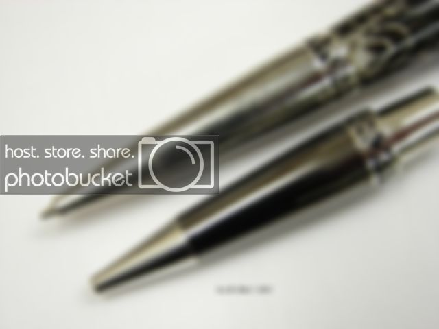

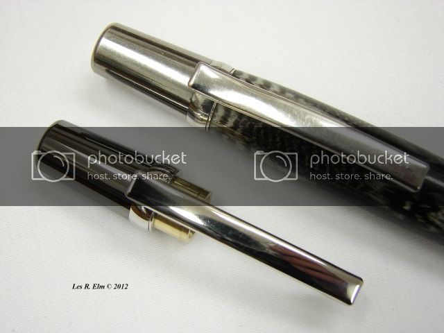

The last two photos shows a comparison of new Black Titanium/Platinum fitting and the used Black Titanium/Platinum fittings.
Les
Ha ...it looks to me like she dropped it in the driveway and found it a few weeks later. Definitely abuse. The end of the clip even has a dent in it. If it was me and she has purchased several pens from you, I would polish up the feather blank and put it on new hardware and lose the $10.00 on the kit. Then I would tell her it is not a Bic and not meant to be treated like one.
I looks like she let it ride in a very abrasive environment. I can't really see that much wear in the plating that would indicate a poor plating issue, but that might just be the pictures. If she has bought a lot from you then if I were you I would just replace the components and make her happy. But I also would instruct her about the proper protection of a pen. I tell my customers that it is a fine writing INSTRUMENT, so just like a instrument that you would play if you do not treat it very carefully then it probably will have scratches and may not work properly if it is abused. Most people get that before I tell them, but I try to tell them anyway so they don't expect it not to scratch if they drop it on concrete. My 2 cents, hopefully it helps a bit!

This one I would have to say the problem is both.
1) The pen style in question is well known for very poor quality plating for starters.
2) It appears the user has a ring on her right hand.
I did some basic testing few years ago on durability. This is consistent with every day use. The real problem here is a sub standard quality kit being used every day is way less than desirable conditions. You need something very durable.
I would agree to this besides the fact that the plating was rhodium and black titanium. What platings are better than those? I cant think of any.
Well I agree that this person uses that pen a lot so, is obvious that she needs something with a more durable plating however, is only so much any plating will take before damage starts to be apparent.
On the other hand, there is also another lesson to be learn from this pen and that is, the feather blanks used on it, has been put through "the works" and is still in great shape so, at least, that shows to be a hell of a strong barrel. I don't know if the resin was simply polished or had the CA treatment, that would be something also of interest to know...!
We may need to have one of our "steal pen makers" gurus to make a stainless steal pen for her, certainly would resist scratches a lot more...!
As to what to do, only you are in the position to make that decision...!

I have to disagree with the poor plating statement. I do believe that this pen has seen some heavy, every day use but I don't believe for a second that it's a plating problem. I'm also not sure how the scratches are from a ring. I wear rings and I can't for the life of me figure out how a ring contacts the pen during normal handwriting, unless it's on the index finger.
I think this kind of scratching is due mostly to how the pen is stored.
I haven't had any trouble with this brand of pen, and I have quite a number of them in use.
As far as the original issue goes Les, I would replace the components and tell your customer that you think the reason for the scratches is the method of storage

Did you overlook the massive color shift?
The other question is if the plating is good and all that then you would think the blank would have scratches and pitting as well :) from the photo's they do not. Riddle me that one before you discredit the plating quality.
Scratches is indeed in how it is stored but every day use it will see loads of abuse which most of these kits are not designed to see.

Concur with above comments. Definitely scratches. I did not notice any corresponding scratches on the pen blank. CA finish??

Rhodium is a completely different element than chromium. And it is in the precious metal group, which is why they use it in jewelry.
I had a similar problem with a pen that I had made for my wife. I found out that she carried it in her purse where she carried emery boards that she used on her finger nails. You might want to inquire if this is the case with your customer.
Well my opinion means nothing but it has never stopped me from giving it. To me it looks like both, abused and weak plating. But what would I do about it? I'd replace the components and give it back to her with a pouch to put it in. You stated she had bought a lot of higher end pens from you, I'd want to keep her happy.
edstreet;1442233 The other question is if the plating is good and all that then you would think the blank would have scratches and pitting as well :) from the photo's they do not. Riddle me that one before you discredit the plating quality. Scratches is indeed in how it is stored but every day use it will see loads of abuse which most of these kits are not designed to see.[/QUOTE said:
Too me it looks like the blank is pretty scratched as well.
Les can you show us the blank or confirm if the blank is scratched as badly as the hardware. If it is then I think it is definitely "abuse" from storage method. My recommendation is to replace based on the fact she is a repeat and good customer and recommend a different way to store it in her purse. This pen looks very similar to one actually 2 I made my wife and it was plain abuse from rattling around in her purse.

Black Titanium is a 0.05 to 1.5 micro plating of Ti-6Al-4V, for those that are not bladesmiths that is 4% vanadium, 6% aluminum and the rest titanium. Basically in a nutshell it is a titanium-aluminum-nitride coating. As you can see 0.05 to 1.5 microns is HUGE. Now do I need to post a new topic and ask "how thick is your plating?" like I did with the CA coat? ;)
As for the rings comment I was going by patterns on the clip vs patterns on the ends. there is a vast difference in type of scratches, the ones on the clip looks almost like some type of ring, could be something else to, is contacting it in a linear manner vs the 2 ends is circular which indicates vibration which is being loose in a bag. Of all the sanding we do on these damn things we should be very much in tune with scratch patterns and what they are :)

'Black Titanium' is TiAIN, i.e. Titanium aluminium nitride , the aluminium % is well over 50% commonly 70%. This is the heavy industrial one anyways. What they are putting on pens I am pretty sure is vastly different as there is a distinct change in the plating over time. Coating cost is also around $2.50 to $4 per item depending on size. My suspicion is some type of anodized dyed aluminum plating.
Either way I dont wish to derail the topic and getting back on topic education and communication is always critical in sales. With every knife I make I give them a crash course in usage, cleaning, storage. Something that I wish all makers would do. Ultimately I would think the previously mentioned pen bag would be the best choice.
I think I would be happy to see a pen come back like that after 14 months. She obviously uses her pens and she should be able to keep one in her pocketbook but, she should expect it to get that kind wear. There is a stainless steel version of that pen on lazerlinez that is a bit more expensive but would also show wear after being run around a pocketbook with her 44 Mag. I wonder if she would be offended if you repair it and simply charge her for the components? She could get this done every year and have a beautiful pen? After all this type of pen can be assembled in just a few minutes! Or you could offer a rebuild option for say 2x the kit price?
Ask her if she feels that a $10 charge for repair sounds fair to her and throw a new kit on it. Polish up the blank while it's apart and send it back to her good as new. $10 every 14-months of use for restoring a nice feather blank pen like that shouldn't be viewed as an issue by a customer if it's explained properly.
All of the comments on the cause of the scratches are right on target. However, if you can, replace the pen with a nice sleeve and remind her about the effect of keys, etc. She sounds like a customer you want to keep and a replacement would go a long way to keeping her loyalty. Sometimes we just have torecognize we do not live in a perfect world and that our "customers" can do some of the dumbest things we can imagine. Just like we do sometimes.
She's a repeat customer of high end pens and the pen in question probably sold for quite a bit. As such, I would dissassemble the pen, polish the barrel, and replace the components. I would return it to her in some sort of pen pouch or leather case and have a conversation about keeping the pen protected while it is rattling around in her purse.
I carry the click version of that pen in my shirt pocket and have done so on a daily basis for quite some time, I'm on about my third or fourth refill. Mine looks nothing like that! With the exception of a scuff here and there mine still looks close to what it did the day I assembled it. I'm with the others, she needs a pen sleeve or something to keep it away from the sand paper and blasting materials.
