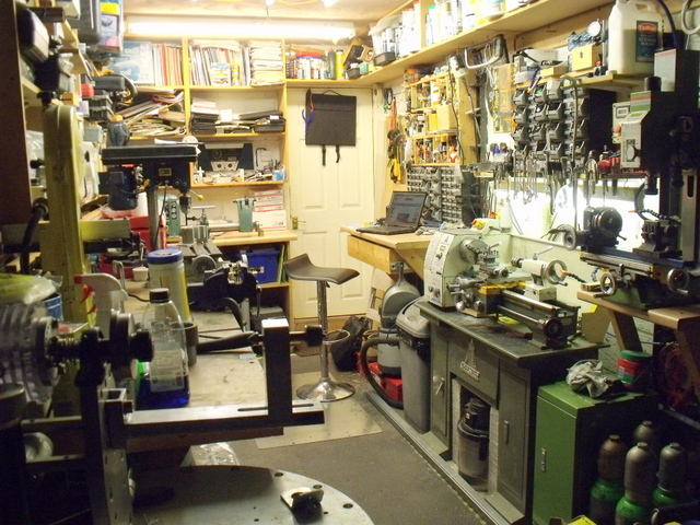

Mmmmm...the only things you should have on your walls are shelves and other storage...:biggrin: If you can see the wall then you are just wasting the space!!!:wink:
My "studio" is in the basement portion of my split level house. The basement is framed out, insulated, dry walled and painted in the event that I ever wanted to use it as living space again. I have several large cabinets mounted on the walls and I use a lot of french cleats to hang tools on the wall.
