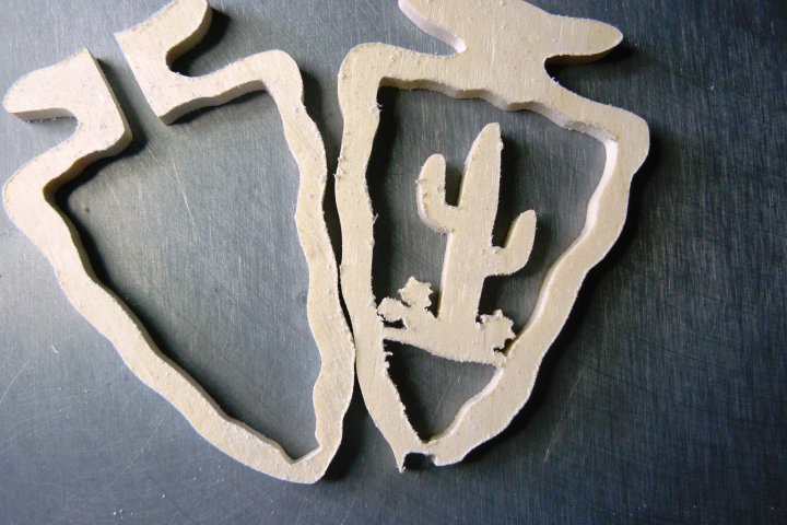

I switched from Olsen blades to the FD myself. I took comparison pictures awhile back and there is a huge difference in the fuzzies. Every 3rd tooth is reversed and I use mostly the #3 ultra reverse for my cuts.
Here are the comparison photo's.
The first one is done with the Olsen #2 that I used to use, and I used alot of them. They also wore very easily.
The second is done with the FD blades and I can use them a bit longer.
It will all depend on what you are cutting. But as I always say "To Each His Own."

But Olson makes reverse-tooth blades as well which makes less fuzzies :biggrin:. Most people will respond that they use Flying Dutchman... I can't cut with them myself.
Olson makes many different types but my favorite blades are just the ordinary reverse tooth ones. This series wears faster than some of their others and probably faster than FD's but the control on them is what really matters. The blades cost about 25 cents each... I don't care if they wear a little faster than some others.
Mike from FD is a really nice and helpful guy. Because of this, Sheila and I have tried several times to work with his blades and we just can't make them work for us, despite us both wanting them to.
I do agree about the control. I am not ditching the Olsen blades at all. They are a great buy and work great, but the saw is also a factor on how each blade works. I still try to use my Olsens, (i have so many lol) but only when I am test cutting something. I tell you what though, the tension between the 2 is a huge difference.:biggrin:
