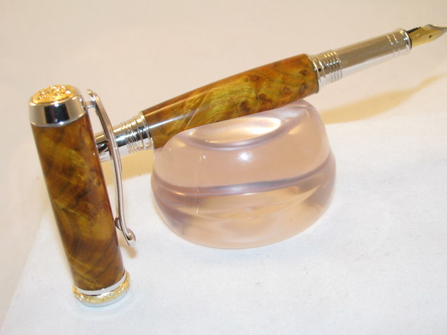

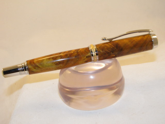

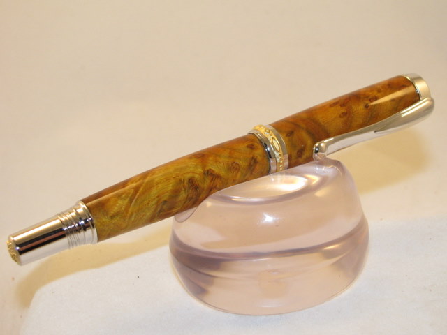

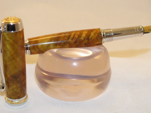

I am often given "grief" when my penmaking friends see my "collection".
EGAD!! The "resinator" has WOOD pens!!!
Here's one I did this weekend:
Chittam(?) smoke wood with some figure, thanks to Dawn for the blank -- sometimes having the right connections is helpful!!
Comments welcome!!

Very nice Ed. I like it :smile::smile: See, even natures natural creations can be as beautiful as resin. All thou some of your resins are pretty cool.
Keith "mrburls"
Very nice pen with a superb finish :smile:
I wish I had connections :frown:
May want to PM the PR_Princess. I know she will have some blanks available, as soon as I get the nerve to cut the "blocks" into "blanks".
Basically, this came off of one of her burls. I picked the "cruddy piece" for me. The rest SHOULD be even more "figured". Now that I have seen it and turned it, I am less worried about ruining her burl in the cutting process.
Comes alive, as you turn it and it is NOT difficult to turn.
Great looking pen Ed! Your finish really gives that wood depth, and the kit is perfect with the gold highlights matching that woods color.
