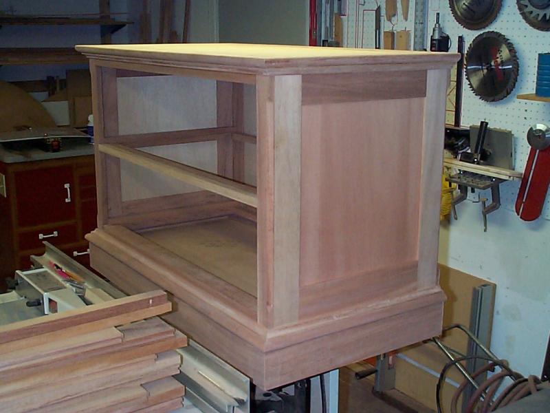

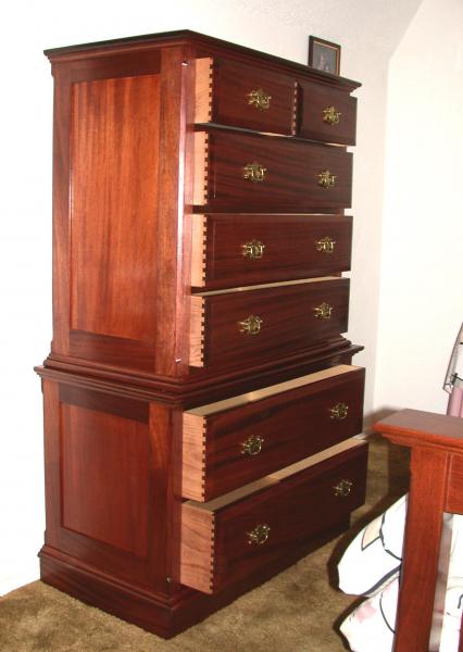

Yes, I am after a pretty good system. Aside from turning, I also have been making furniture and larger projects for the past 30 years. Here is a chest of drawers I built a couple years ago from mahogony and a shot of the matching dresser coming along. We will be moving soon so not only do I have to build a new shop, I'll also be busy making lots of new furniture and building an outside entertainment area so I can see a LOT of dust coming my way! :smile: Now's the perfect time to do it right!
I called Onieda and talked with a nice lady who said to send them a layout of the shop showing where my major tools will be and they'll do a layout for me showing a ducted system.
George, that is some great looking furniture that you make. Talented pen designer/maker... no fair. You have been blessed with 'too' many gifts. : )

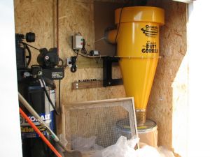

I have the Oneida Dust Gorilla and absolutely love it. It's worked flawless for four years and has PLENTY of power. In fact, if you forget to turn it off when parting something off, it's GONE! I've had to recover many an item from the dust bin.
If you get one I highly recommend getting the "Bag Gripper". It's a vacuum system that fits in the waste barrel and allows you to use plastic bags to catch all the waste. I can't even imagine having to empty the bin all the time.
Also, get a floor sweep. That way when you clean up:rotfl::rotfl::rotfl::rotfl::rotfl: you can just sweep everything into it and SWOOSH, it's gone!!
They're customer service is top notch and like you said, if you send them a shop layout they'll design a system for you. That's what I did.
Check out my photos in the "SHOP SHOTS" section and you can see more of my system.:wink:
