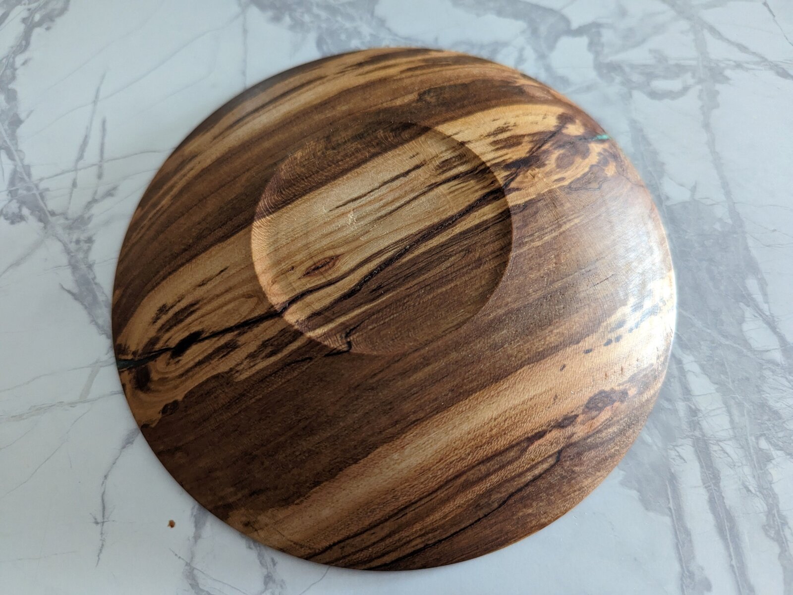

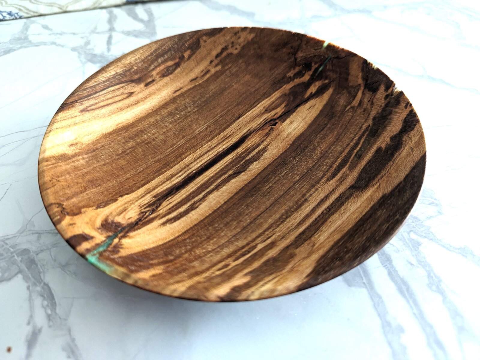

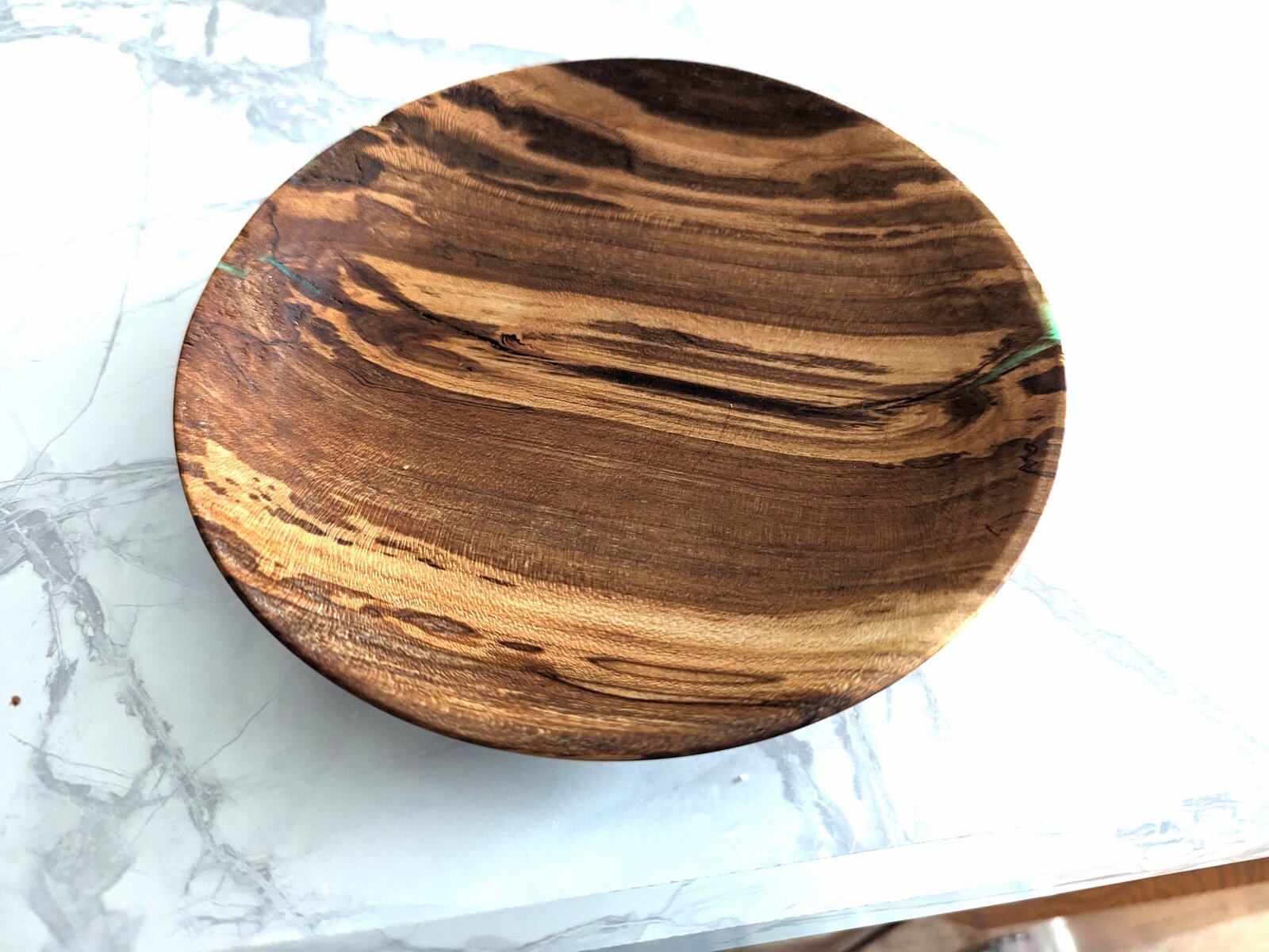

Took down a smallish Weeping Cherry in the backyard. The trunk was about 17" diameter so, I decided I'd do it proud by at least creating some beautiful turnings from it. The graining is crazy and I can't wait to turn a bowl.
Anyways, here is a 7" plate that I twice turned. After the first turning (Roughing) I dried the roughed out piece in my small convection oven I use for stabilizing. When I did that the bowl developed some gi-normous cracks and was a bit punky. I stabilized it, colored some epoxy and filled the crack(s) then second turned it.
Was a lot of work but all it cost was time and some stabilizing solution.
Let me know what ya'all think!

Beautiful work. The wood is nothing short of spectacular. Ordinarily, I wouldn't take that much trouble on a single project but this one was definitely worth it !!!

Thank you,
Since I retired, I have time to do these types of things. I like the challenge and seems like eveytime I save one of these pieces it turns out to be spectacular and I was glad I spent the time.

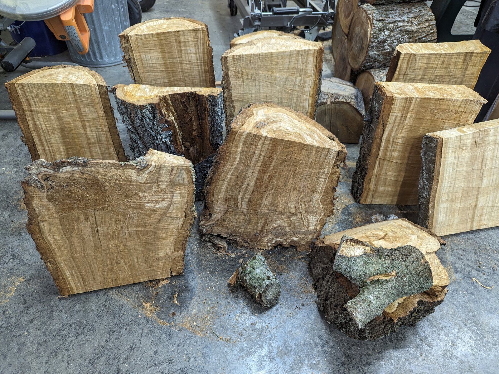

I actually have quite a bit of the timber. I have three center pieces (with pith) that should make for some very interesting platters.
