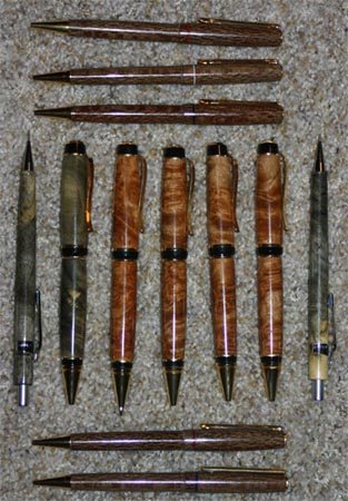

Received an order for 12 pens while I was in Provo. Finished it this afternoon. 4 cigars in big leaf maple burl, one cigar in buck eye, 5 modified slimlines in macadamia nut and two pentel pencils in buck eye. As always, comments welcome. These are nothing special, but I thought I would share anyway.

Don, you are WAY too modest, as always. Those look GREAT! What finish did/do you use?
My only comment is, isn't the tip sticking out a little far on that cigar?

Jim: Thanks! I use CA/BLO finish. Sanding sealer, sand to 12000MM, apply 3 coats of CA/BLO and sand to 3200MM, buff with tripoli and white diamonds and final polish with HUT Ultra Gloss and a final treatment with TSW. And, yes, the pen tip is out, but it was twisted to be out (I hope). I'm sure it was. Checked and double checked all the pen for proper functioning.
Justin: I was going to make closeup pics but packaged the pens this morn to be shipped. I would unpack and shoot closeups, but the pens must meet a deadline and must be mailed this morn. What did you want to see close up. The big leaf maple, macnut, or the buckeye.
